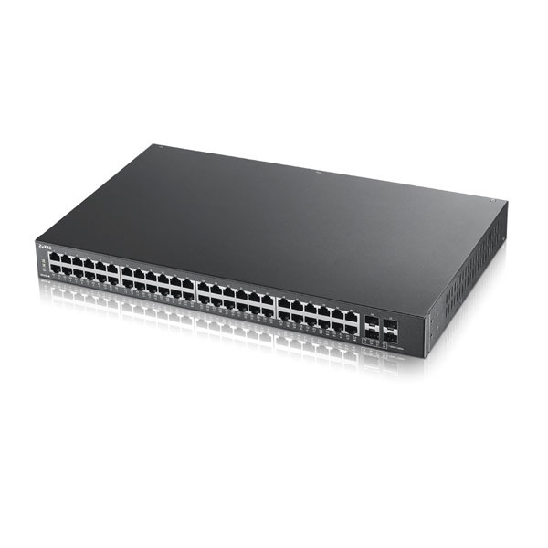

G Skrevet 26. februar 2014 Forfatter Skrevet 26. februar 2014 (endret) Så en heftig proff-router klarer å avlaste switch'en slik at den får gjøre oppgavene sine enda bedre? Må si at jeg nesten er av det grønne slaget. Mer spørsmål fra den grønne leiren kommer senere Spec på switch'en: Tror jeg burde ha det som behøves gitt Gigabit som begrensning. Dette er en relativt avansert sak. Kilde til spec. er Broadbandbuyer.co.uk http://www.broadbandbuyer.co.uk/Shop/ShopDetail.asp?ProductID=14572 The ZyXEL GS1910-48 48 port switch is packed with features to meet the network demands for Small and Medium Businesses (SMB). This ZyXEL GS1910-48 switch provides comprehensive smart switching capabilities such as Access Control List (ACL) rules, 802.1p Priority Queues per Port and 802.1AB LLDP and LLDP-MED, etc and delivers the essential network features for businesses with easy-to-use management at a right price. Furthermore, the ZyXEL GS1910-48 provides GbE bandwidth to desktops to ensure sufficient bandwidth for all business communications, data delivery and daily operations. Taking advantages of GbE, businesses can create premium worry-free IT environment and expand operations with desirable efficiency and productivity. Key Features Forty-Eight (48) 10/100/1000 Gigabit Ethernet RJ45 Mbps switching ports and Four (4) SFP Slots Advanced Smart GbE L2 ACL switching features with 48/88/104/176 Gbps non-blocking switch fabric Supports IPv6 making your network future-proof for next generation of network applications and expansions GbE bandwidth for desktops ">When videos of higher resolution and data flow constantly evolve, network user demands might not be satisfied and business operations hampered by insufficient bandwidth. The ZyXEL GS1910-48 provides GbE bandwidth to desktops to ensure sufficient bandwidth for all business communications, data delivery and daily operations. Taking advantages of GbE, businesses can create premium worry-free IT environment and expand operations with desirable efficiency and productivity. Standard Warranty: Lifetime Limited Standard Compliance IEEE 802.3 IEEE 802.3u IEEE 802.3ab IEEE 802.3z 1000BASE-X IEEE 802.3x flow control IEEE802.3az EEE support IEEE802.1p CoS support Full-duplex and half duplex operation with IEEE802.3x flow control and backpressure Store and forward N-way auto-negotiation Traffic Management and QoS Port-based VLAN MAC-based VLAN Protocol-based VLAN 802.1Q VLAN tagging Guest-VLAN Voice VLAN Storm Control (Unicast, Broadcast, and Unknown traffic)802.1p Priority Queues per Port 802.1p Queuing method (scheduler) Input priority mapping QoS control list (QCL mode) Queue egress shaper Tag remarking Rate Limiting, port based (ingress/egress) Rate Limiting, per IP/TCP/UDP per port 802.3x flow control Policy based Prioritisation Class of Service (CoS) 802.1p Class of Service (SPQ, WFQ, SPQ/WFQ combination capable) DiffServ (DSCP) Policy based CoS Resilience and availability IEEE 802.1D STP/802.1w RSTP/802.1s MSTP IEEE 802.1s instances IEEE 802.3ad LACP (standalone mode) Loop guard Port error Recovery Security 802.1x Port Security MAC authentication MAC address limit Layer 2 MAC filtering Layer 3 IP filtering Layer 4 TCP/UDP socket filtering BPDU guard Static MAC forwarding Multiple RADIUS servers Multiple TACACS+ servers 802.1x VLAN and QoS assignment by RADIUS RADIUS authentication TACACS+ authentication RADIUS accounting RADIUS authorization TACACS+ authorization SSL DHCP snooping ARP Inspection UPNP IP/MAC/Port binding (dynamic/static) IP/MAC/Port binding dynamic to static Policy-based security filtering Port Isolation IP Source Guard ACL Packet Filtering (IPv4/Ipv6) ACL for policing/port copy (incl. ACL Wizards) Layer 2 Multicast GMP Snooping (v1,v2,v3) IGMP Snooping Fast Leave IGMP Snooping Statistics IGMP Throttling MVR support IGMP Filtering IGMP proxy mode & snooping mode selection IPv6 MLD snooping (v1,V2) IPv6 Ipv6 management IPv6 over Ethernet (RFC 2464) Dual Stack (RFC 4213) ICMPv6 (RFC 4884) Neighbor Discovey (RFC4861 Pv6 Addressing Architecture (RFC 4291) IPv6 MLD snooping SNMP/UDP or TCP/IPv6 Discovery 802.1AB LLDP LLDP-MED Network Management Web-based management SNMP v1,v2c, v3 RMON: four RMON groups 1, 2, 3, 9 (history, statistics, alarms, and events) for enhanced traffic management, monitoring, and analysis Dual image NTPv4 Client DHCP relay DHCP client DHCP option 82 Syslog Port mirroring & Remote Port mirroring DNS client, Proxy sflow EEE MIB Information RFC1213 MIB II RFC 2819 RMON (Group 1,2,3, 9) RFC 2863 Interface Group MIB using SMIv2 RFC 3411 SNMP Management Frameworks RFC 3414 User-based Security Model for SNMPv3 RFC 3415 View-based access Control Model for SNMP RFC 3635 Ethernet-like MIB RFC 3636 802.3 MAU MIB RFC4133 Entity MIB v3 RFC4188 Bridge MIB RFC4668 RADIUS auth. Client MIB RFC4670 RADIUS Accounting MIB RFC 5519 Multicast Group Membership Discovery MIB IEEE802.1Q Bridge MIB IEEE802.1 MSTP MIB IEEE802.3AB LLDP-MIB IEEE802.3ad LACP MIB IEEE802.1X PAE MIB TIA 1057 LLDP-MED Certification Safety: LVD EU RoHS compliant EMI: FCC, CE, CNS, ICES BSMI: CNS14336 & CNS13438 Model GS1910-48Ports 10/100/1000 Base-T, fixed48Performance Switch capacity (Gbps)104 Switch forwarding Rate (Mpps)77.4 Packet buffer (Byte)4 M MAC address32K Power requirement Input voltage of ACAC Power input (100 ¨C 240 V) Maximum power consumption (Watt)519 Environmental Specifications Operating temperature0 50C/32¨H to 122¨H Storage temperature- 40 70C/-40¨H to 158¨H Operating humidity10% to 95% (Non-condensing) Other Specifications MBTF>100000 Heat dissipation (BTU/hr)1769.8 Physical Specifications Item dimensions (WxDxH) (mm/in.)440 x 350 x 44/17.32 x 13.78 x 1.73 WeightItem weight (kg/lb.) Package Contents ZyXEL GS1910-48 Switch Power Cord (UK Plug) Rackmount Kit Rubber Feet Installation Guide Warranty Registration Declaration of Conformance Certificate Warranty Lifetime Limited Endret 26. februar 2014 av G

ChrisCo Skrevet 26. februar 2014 Skrevet 26. februar 2014 (endret) Så en heftig proff-router klarer å avlaste switch'en slik at den får gjøre oppgavene sine enda bedre? Nei, omvendt.. LAN trafikk går på Lag 2, som switchen tar seg av. Så all intern trafikk går utenom routeren... Er kun trafikk som går inn/ut fra Internett som routeren tar seg av... Switchen din vil nok duge helt greit for deg og til ditt bruk.. Men med tanke på prisen, så blir jeg litt tvilende til stabilitet og hastighet, særlig under høy belastning.. Men som sagt, det funker nok fint til ditt bruk...;-p Før du handler inn X antall routere/AP'er, så ta en survey sjekk oppå kryploftet ditt så du kan kartlegge hvor du bør plassere dem og hvor mange du behøver.. På 100m2 så bør det greie seg fint med en eller to stk... Last ned inSSIDer og sett opp et AP der oppe, og beveg deg rundt så du finner ut av dekningen.. Når signalstyrken går under -70 dBm, så bør vurdere et AP til... Endret 26. februar 2014 av ChrisCo
