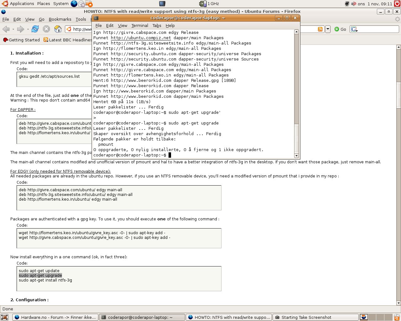

NTFS i ubuntu - > http://www.ubuntuforums.org/showthread.php?t=217009
7193289[/snapback]
