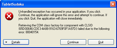

Spartakus Skrevet 5. juli 2007 Skrevet 5. juli 2007 Starter det opp, trykker new game, men får servert en "Unhandeled Exception" Prøvde den på WinXP Pro, sikkert derfor. Klikk for å se/fjerne innholdet nedenfor See the end of this message for details on invoking just-in-time (JIT) debugging instead of this dialog box. ************** Exception Text ************** System.Runtime.InteropServices.COMException (0x80040154): Retrieving the COM class factory for component with CLSID {65D00646-CDE3-4A88-9163-6769F0F1A97D} failed due to the following error: 80040154. at Microsoft.Ink.InkOverlay..ctor() at TabletSudoku.Sudoku.btNew_Click(Object sender, EventArgs e) at System.Windows.Forms.Control.OnClick(EventArgs e) at System.Windows.Forms.Button.OnClick(EventArgs e) at System.Windows.Forms.Button.OnMouseUp(MouseEventArgs mevent) at System.Windows.Forms.Control.WmMouseUp(Message& m, MouseButtons button, Int32 clicks) at System.Windows.Forms.Control.WndProc(Message& m) at System.Windows.Forms.ButtonBase.WndProc(Message& m) at System.Windows.Forms.Button.WndProc(Message& m) at System.Windows.Forms.Control.ControlNativeWindow.OnMessage(Message& m) at System.Windows.Forms.Control.ControlNativeWindow.WndProc(Message& m) at System.Windows.Forms.NativeWindow.Callback(IntPtr hWnd, Int32 msg, IntPtr wparam, IntPtr lparam) ************** Loaded Assemblies ************** mscorlib Assembly Version: 2.0.0.0 Win32 Version: 2.0.50727.42 (RTM.050727-4200) CodeBase: file:///C:/WINDOWS/Microsoft.NET/Framework/v2.0.50727/mscorlib.dll ---------------------------------------- TabletSudoku Assembly Version: 1.0.0.0 Win32 Version: 1.0.0.0 CodeBase: file:///C:/Programfiler/j0rn/TabletSudoku/TabletSudoku.exe ---------------------------------------- System.Windows.Forms Assembly Version: 2.0.0.0 Win32 Version: 2.0.50727.42 (RTM.050727-4200) CodeBase: file:///C:/WINDOWS/assembly/GAC_MSIL/System.Windows.Forms/2.0.0.0__b77a5c561934e089/System.Windows.Forms.dll ---------------------------------------- System Assembly Version: 2.0.0.0 Win32 Version: 2.0.50727.42 (RTM.050727-4200) CodeBase: file:///C:/WINDOWS/assembly/GAC_MSIL/System/2.0.0.0__b77a5c561934e089/System.dll ---------------------------------------- System.Drawing Assembly Version: 2.0.0.0 Win32 Version: 2.0.50727.42 (RTM.050727-4200) CodeBase: file:///C:/WINDOWS/assembly/GAC_MSIL/System.Drawing/2.0.0.0__b03f5f7f11d50a3a/System.Drawing.dll ---------------------------------------- Microsoft.Ink Assembly Version: 1.0.2201.2 Win32 Version: 1.0.2201.2 CodeBase: file:///C:/Programfiler/j0rn/TabletSudoku/Microsoft.Ink.DLL ---------------------------------------- ************** JIT Debugging ************** To enable just-in-time (JIT) debugging, the .config file for this application or computer (machine.config) must have the jitDebugging value set in the system.windows.forms section. The application must also be compiled with debugging enabled. For example: <configuration> <system.windows.forms jitDebugging="true" /> </configuration> When JIT debugging is enabled, any unhandled exception will be sent to the JIT debugger registered on the computer rather than be handled by this dialog box.
j000rn Skrevet 5. juli 2007 Skrevet 5. juli 2007 Har bare prøvd med XP TablePC Edition og Vista. Og begge de to støtter "ink"... Synd for deg :-P
