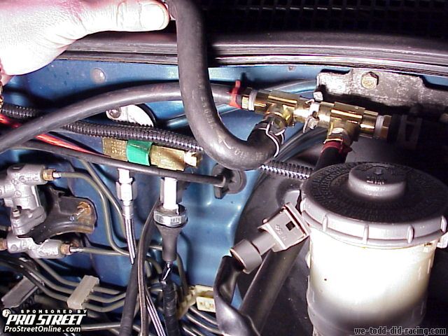

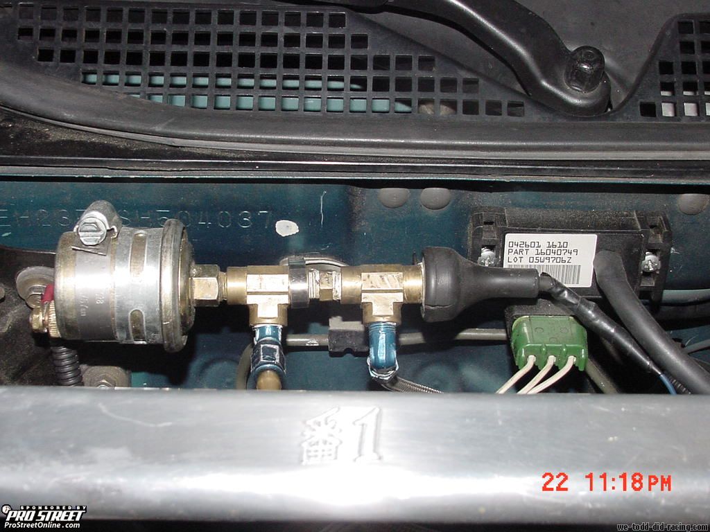

Hondaen Skrevet 21. januar 2006 Skrevet 21. januar 2006 Er mange tråder som omhandler akkurat dette.. Og velrenomert? Ingen seriøse turbobyggere bruker FMU...lol "The fitting will brake off your block, it happens 90% of the time. Run a feed off your block first! " "YES snapped mine at the track. has to tow the car hoime. luckley i love 5 miles from kennedale. put it in the firewall and save yourself some troubles." "If the tee and stock sending unit are hanging from the back of the block, theres a possibility that the vibration/jossle (whatever you wanna call it) will make the threads of the tee just break off a chunk of the block." http://www.honda-tech.com/zerothread?id=862213 f.eks Slik bør det gjøres:
