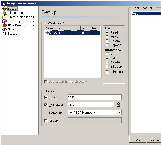

Har et problem med bulletproof jeg også.
Får logget på serveren, men får ikke listet mappene.
Trykker jeg refresh så står den bare å venter.
Hva kan være feilen?
Har en mappe some jeg har kalt Home også har jeg lagt noen bilder der bare.
LIST
150 Opening data connection for directory list.
Data Connection opened.
425 Cannot open data connection (10060).
Får denne feilen
My users can not list (425 Cannot open data connection (10060))
1) If you are behind a router / firewall check FAQ : BPFTP Server behind a router
2) If remote user is behind a firewall, tell him to switch his ftp client to passive (PASV) mode
3) Check that this user have right to list (+L) in user account / access rights
4) FTP Client is behind a NAT, you should see a list attempt with PORT 192,168... command or PORT , user should switch his ftp client to PASV (passive) mode.
