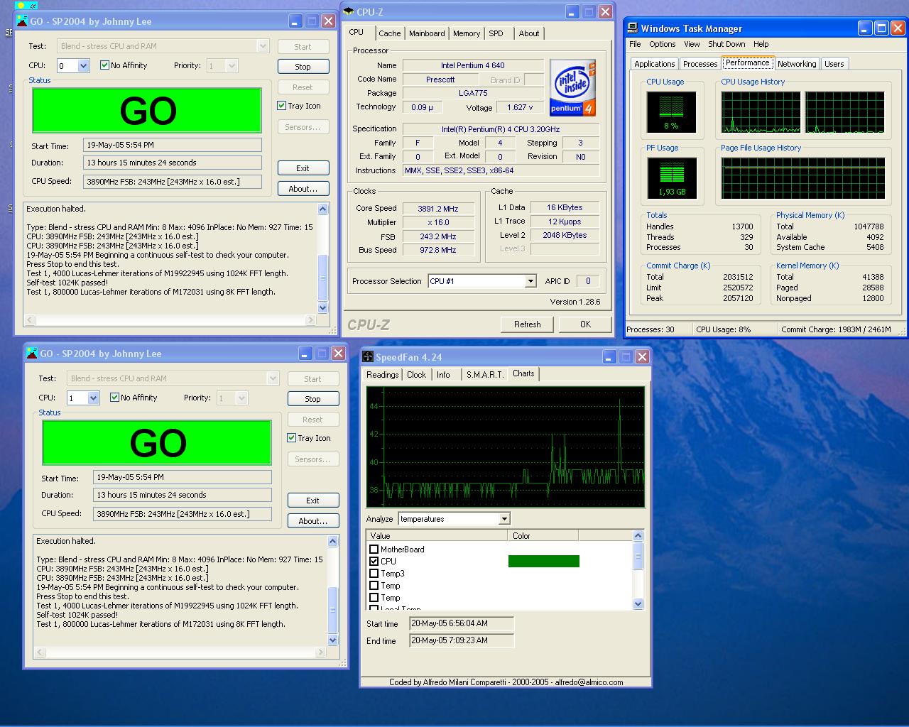

Started stressprime2004 with two copies as advised. It runs now for 1 hour 50 minutes. Tempreture is still at 40C. What is strange however, that CPU is only 5% loaded. I thought this stressprime is supposed to load CPU 100%...
There is definitelly some brake in a setup. Has been running stressprime 2004 for 5 hours 45 min and tempreture never exceeded 40C. This is probably why CPU is loaded only around 5 %. As soon as it starts loading more work on CPU and the tempreture rises, some brake works and brings CPU load down. At least I suspect so.
Does any one know if this could be the case? Where could I fix it?
After 13 hours of test the tempreture is still at around 40C. At least it exceeded 40 few times, but total level does not make sense to me. Added the screenshot of all applications opened and showing the values.
