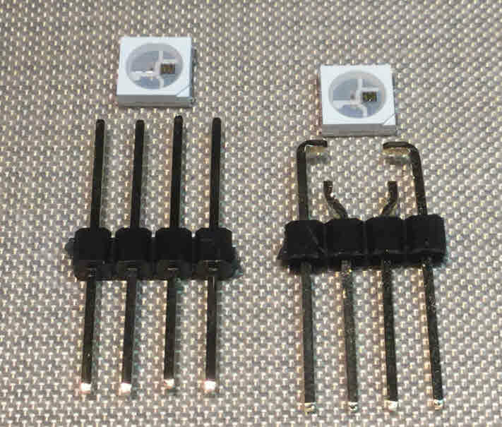

Two more ideas.

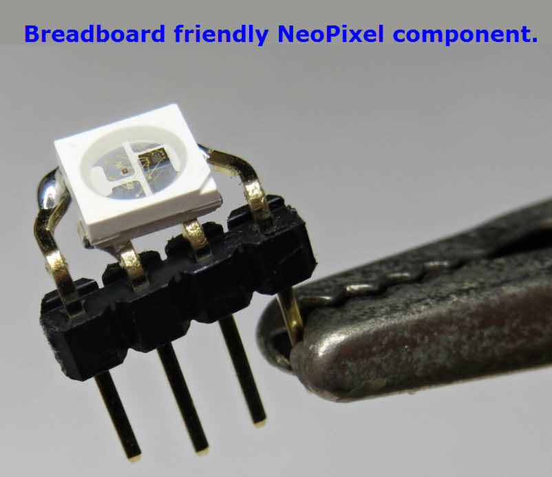

Make a breadboard friendly Neopixel for software development.
Make breadboard friendly switch assemblies from two pin SMD switches.
The center header pins are pulled out and discarded.
Avoid plugging header pins next to the center of the breadboard, use these holes for DIP sized pins only.

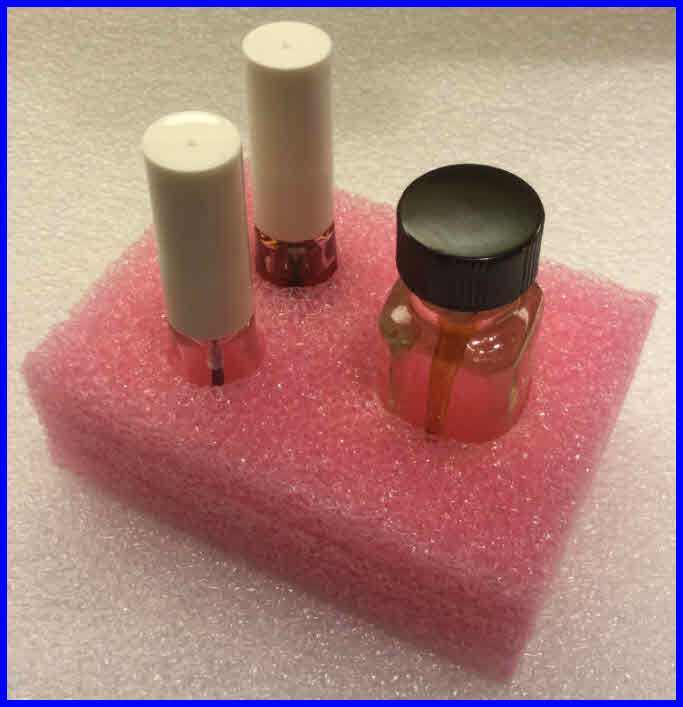

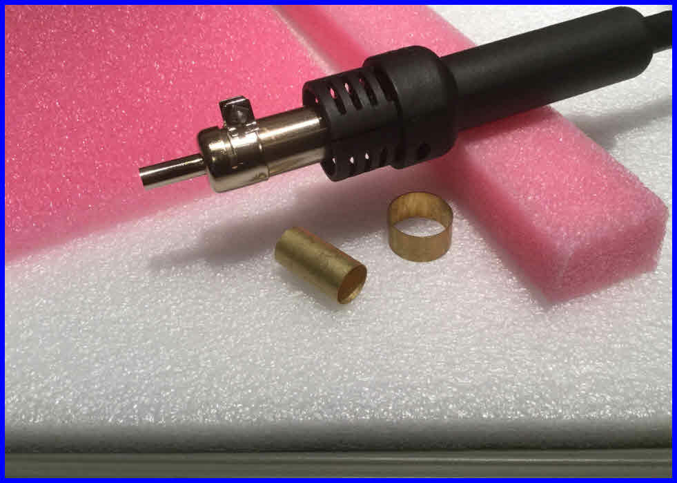

Electronics parts/equipment is often packaged with foam to prevent shipping damage.
One of these foams has a translucent look and polyethylene texture, not sure of the exact name.
This foam has a low melting temperature and when cut with a hot instrument gives a clean edge.
One use for recycling this foam is for tool shadowing.

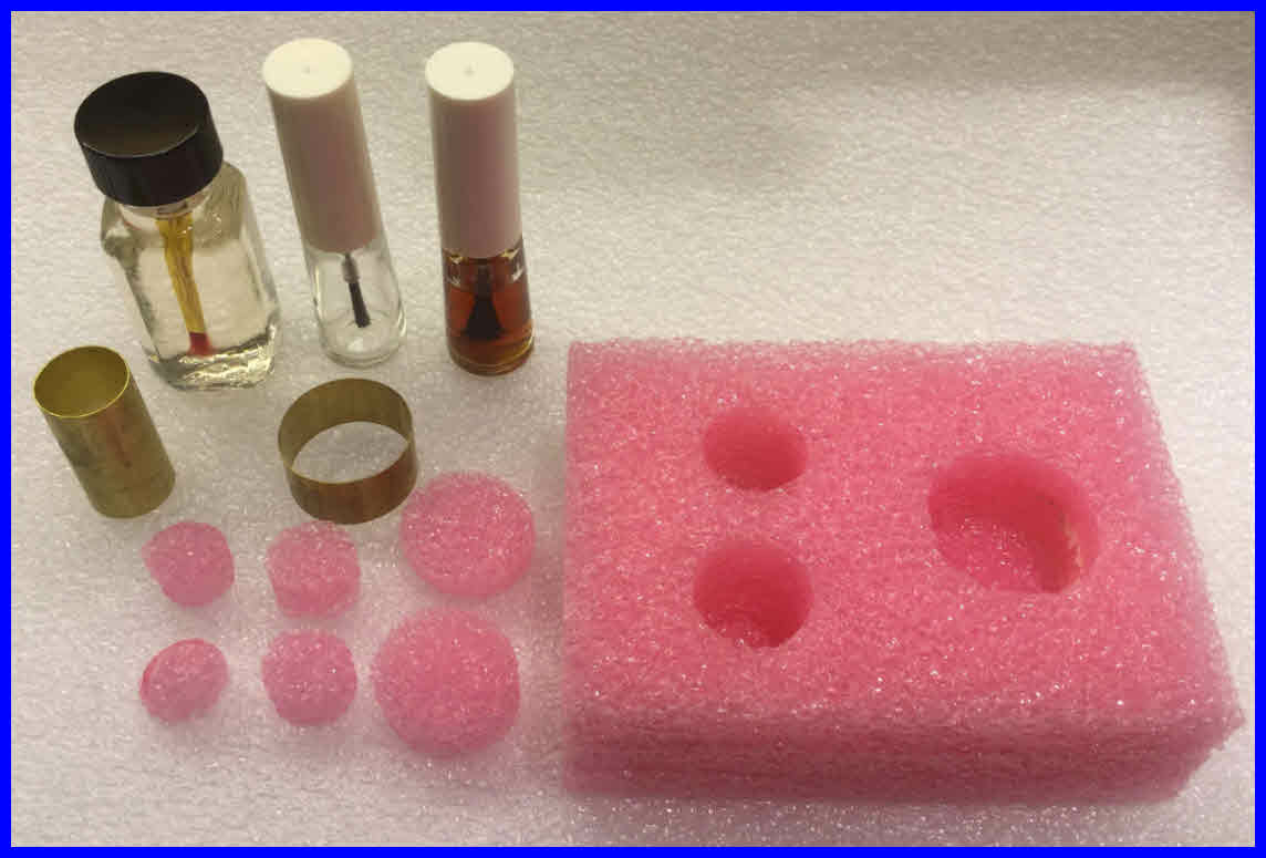

In the image below there are two brass tube pieces, some examples of the foam and a hot air wand set at ~450'C.

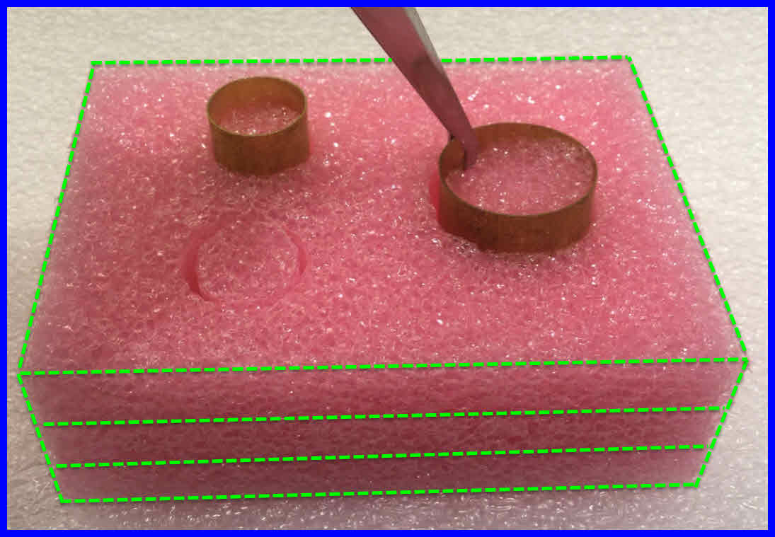

You can use: double stick tape, one half inch foam and a table saw to create a thicker foam block.
I usually tape the perimeter only so the center cut-outs remove easily.
Place a weight on the foam sandwich for several hours for the tape to become effective.
Heat the brass pipes to 450 degrees C then cut through the top two of three levels of the foam.
Remove the cut-out pieces and insert your tools, bottles, etc.
Note: the larger square bottle will compress the hole it fits, giving a firm grip.
