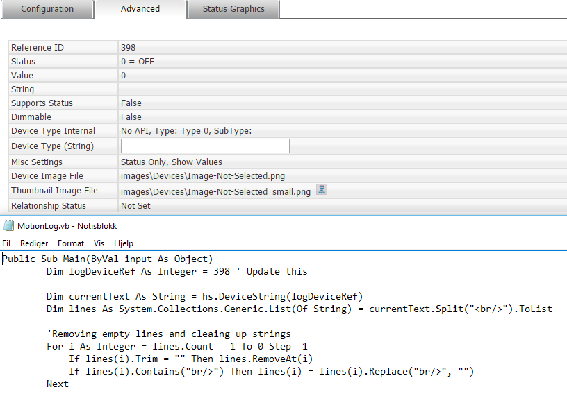

Moskus Skrevet 6. januar 2016 Skrevet 6. januar 2016 Aaargh. Oppdater scriptet til dette: Public Sub Main(ByVal input As Object) Dim logDeviceRef As Integer = 1081 ' Update this Dim currentText As String = hs.DeviceString(logDeviceRef) Dim lines As System.Collections.Generic.List(Of String) = currentText.Split("<br/>").ToList 'Removing empty lines and cleaing up strings If lines.Count > 0 Then For i As Integer = lines.Count - 1 To 0 Step -1 If lines(i).Trim = "" Then lines.RemoveAt(i) If lines(i).Contains("br/>") Then lines(i) = lines(i).Replace("br/>", "") Next End If 'Remove the bottom entry if needed If lines.Count = 10 Then lines.RemoveAt(lines.Count - 1) 'Creating the device text Dim newText As String = Now.Date & " " & Now.ToLongTimeString & " - " & input.ToString If lines.Count > 0 Then newText &= "<br/>" If lines.Count > 2 Then For i As Integer = 0 To lines.Count - 2 newText &= lines(i) & "<br/>" Next ElseIf lines.Count = 2 Then newText &= lines(0) & "<br/>" End If 'Adding the last lines without the HTML break newText &= lines(lines.Count - 1) 'Updating the device string hs.SetDeviceString(logDeviceRef, newText, True) End Sub ... jeg glemte å sjekke for at det ikke var noen tekstlinjer fra før. Jeg skrev om scriptet hos meg selv og DER er det jo tekstlinjer fra før...
GeneralVirus Skrevet 6. januar 2016 Skrevet 6. januar 2016 (endret) Nope Jeg skal bare lage en enkel ny device? Eller må jeg endre noe på virtual device? Running script C:\Program Files (x86)\HomeSeer HS3\scripts\MotionLog.vb :Exception has been thrown by the target of an invocation.->Does entry point Main exist in script? at System.RuntimeMethodHandle.InvokeMethod(Object target, Object[] arguments, Signature sig, Boolean constructor) at System.Reflection.RuntimeMethodInfo.UnsafeInvokeInternal(Object obj, Object[] parameters, Object[] arguments) at System.Reflection.RuntimeMethodInfo.Invoke(Object obj, BindingFlags invokeAttr, Binder binder, Object[] parameters, CultureInfo culture) at A.c17b105f989efe61e5979e67bec1ef734.cffd66cb0782c50126727e3fa75582d7a() Endret 6. januar 2016 av GeneralVirus
Moskus Skrevet 6. januar 2016 Skrevet 6. januar 2016 (endret) aargh. Får teste det selv da... Men prøv dette først: Gå til Setup -> Control Panel og kjør dette immediate scriptet: hs.SetDeviceValue(DIN_DEVICEREF_HER, "Linje 1<br/>Linje 2<br/>Linje 3") (det legger bare inn noen linjer. De forsvinner etter hvert... Endret 6. januar 2016 av Moskus

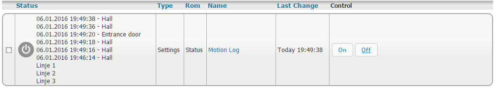

GeneralVirus Skrevet 6. januar 2016 Skrevet 6. januar 2016 (endret) Se der ja, litt fikling så fikk jeg det til. Via device operation satt jeg display status til Linje 1<br/>Linje 2<br/>Linje 3. Funket også med: hs.SetDeviceString(407, "Linje 1<br/>Linje 2<br/>Linje 3", True) Etter dette fikk jeg til å logge via scriptet ditt Moskus. Tips til hvordan jeg kan fjerne On og Off knappen og ikonet til devicen? Endret 6. januar 2016 av GeneralVirus
Moskus Skrevet 6. januar 2016 Skrevet 6. januar 2016 Tips til hvordan jeg kan fjerne On og Off knappen og ikonet til devicen? Gå inn på device'n og huk av "Status Only".

DrLaban Skrevet 14. januar 2016 Skrevet 14. januar 2016 (endret) Se der ja, litt fikling så fikk jeg det til. Via device operation satt jeg display status til Linje 1<br/>Linje 2<br/>Linje 3. Funket også med: hs.SetDeviceString(407, "Linje 1<br/>Linje 2<br/>Linje 3", True) Etter dette fikk jeg til å logge via scriptet ditt Moskus. motion log.PNG Tips til hvordan jeg kan fjerne On og Off knappen og ikonet til devicen? Hva slags "fikling" gjorde du? Jeg har akkurat samme problem her Edit: Glem det. Jeg fikk det til nå. Så at kommandoen under control panel manglet en "true" på slutten. Men jeg ser at den logger 2 ganger ved bevegelse.... Endret 14. januar 2016 av DrLaban
