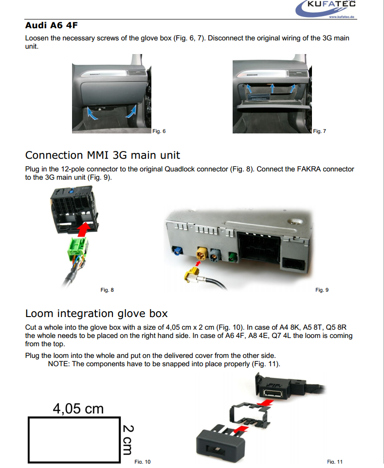

..En Kufatec AMI kobles til på dette viset:

Jeg får prøve å få tak i Transmedia, Kufatec mener dette ikke går lenger:
I have MMI 3G RADIO PLUS, can ¨Cable kit AMI MMI 3G¨be connected directly to
player and work? Why is it so expensive, is there cheaper way to get ONLY AUX? I
need only 3,5mm jack, do not need control from MMI, I can control everything from
the mobile(spotify).
Please help me to find the cheapest and easiest way to get AUX 3,5mm.
Thank you for your request.
An easy way is prohibited by Audi.
But only the cable isn"t enough.
You Need the complete kit :
http://www.kufatec.de/shop/en/audi/a4/a4-b8-8k/ami-audi-music-interface-retrofit-audi-usb?action_ms=1
Tank for very quick answers - even though it is officially prohibited, is it possible? I think Kufatec used to have a simple, cheap way before - something like this link?
http://transmedia.mystore.no/ds_product_info.php/cPath/1453_1162_1468/products_id/2134
No sorry, we haven"t a cheap and easy solution for this.
