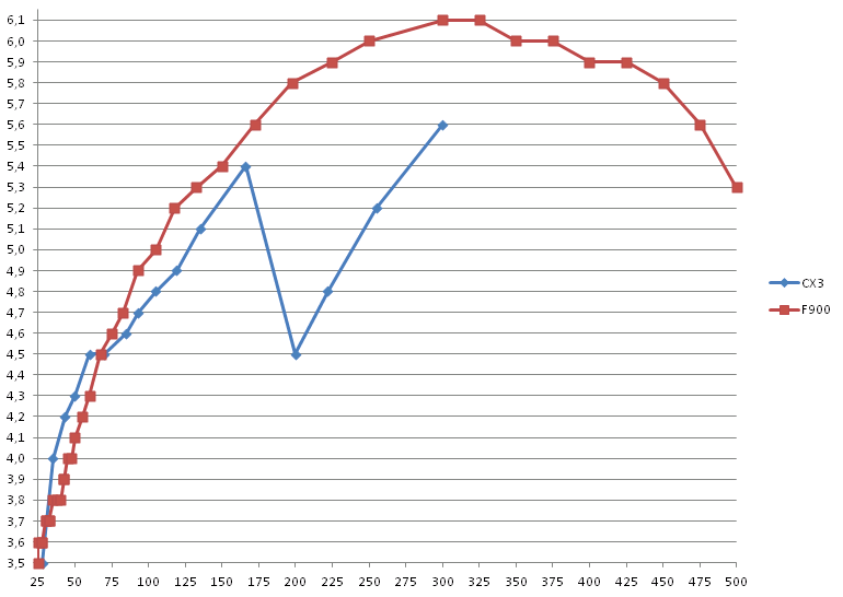

- The zooming steps are somewhat coarse. there are 39 steps of zoom over the entire 20x range (I'm used to 54 on the 10.7x zoom CX3)

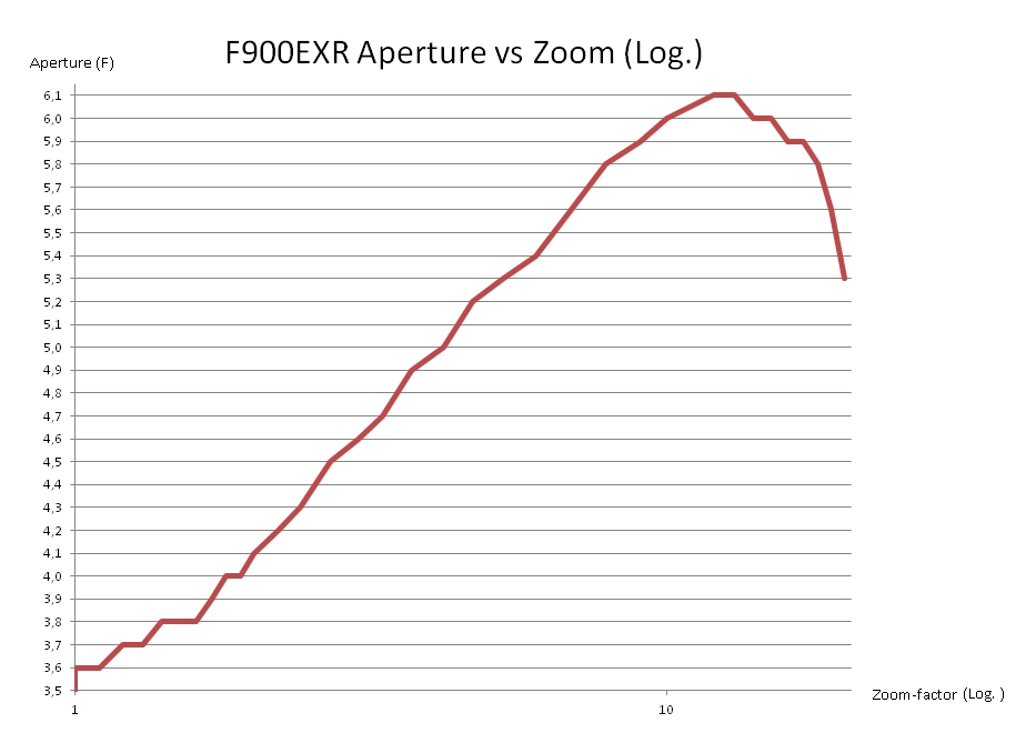

- The lens is over-sold as 20x, "F3.5-5.3", At zoom 6x to 19x it is OVER F5.3! Over the entire 1x to 20x range it is F3.5-F6.1, IMPROVING from F6.1 at 12x towards F5.3 at 20x.

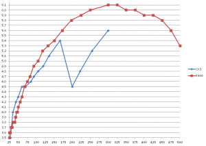

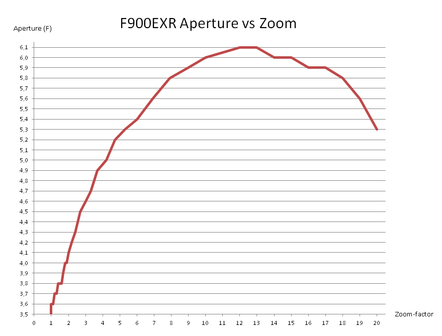

Zoom and aperture
The zoom works in 39 steps. They are easy to produce zooming in. It can be a little hard to zoom out one step (I guess due to the AF)
The real aperture varies in a strange way over the zoom range, getting worse and worse (as expected) going from F3.5 for 1x to F6.1 for 12x. But getting BETTER down to F5.3 for 20x!!
Click table to enlarge to readable size - sorry the CODE-tags are completely unstable in this forum...
The apertures grows almost linearly with the logarithm to the zoom, for zoom between 1x and 12x

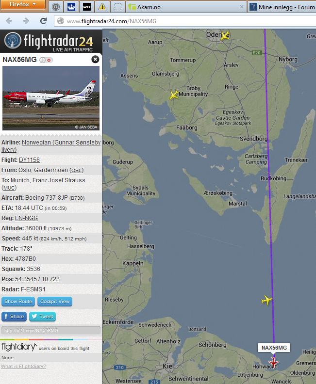

Plane (RYR7WM)
Seen from the outskirts of Svendborg, estimated distance 15Km (12km up, view point 9km off track). Info taken from flightradar24.com, collage:

Plane (NAX56MG) , EXIF: F, 20x, F5.3, 1/220s, Iso100, Brightness=7.68
Straight over my head, 12Km up, much better atmospheric conditions
post-132057-0-81225700-1370282319_thumb.jpg Crop: post-132057-0-50046100-1370506866_thumb.jpg post-132057-0-35150800-1370282296_thumb.png
You can make out the existence of letters under the wing - though not read them. The front paint (including the line on the shadow side) are easily seen.

Indtil ca 175mm ækvivalent følges de ad zoom/aperture, herefter har CX3 det underlige spring og er klart bedre på 200mm, men stiger hastigt og går 'kun' til 300mm hvor forskel atter er beskeden, og F900EXR fortsætter til 500mm ækv.
