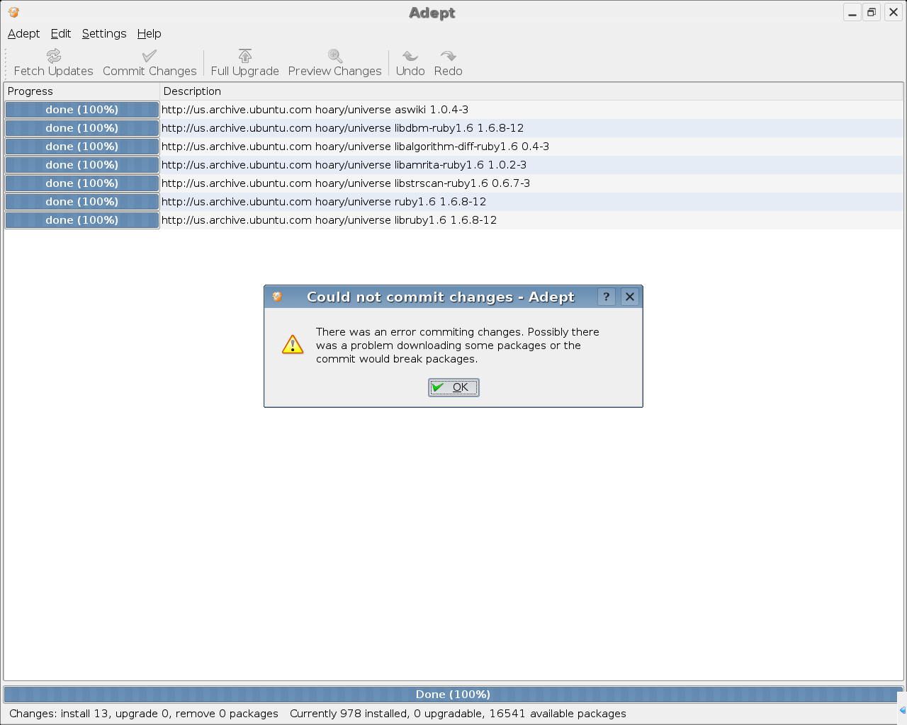

x-ray-cat Skrevet 14. oktober 2005 Forfatter Skrevet 14. oktober 2005 (endret) Det så ut som den greide å laste ned flere pakker nå, og vlc kommer i pakkebehandleren. Men når jeg prøver å innstallere vlcplayer får jeg feilmeldingen: There was an error commiting changes. Possibly there was a problem downloading some packages or the commit would break packages. Kan dette ha noe å si: thomas@arbeidsmaskin-kubuntulinux:~$ sudo kwrite /etc/apt/sources.list Error: "/var/tmp/kdecache-thomas" is owned by uid 1000 instead of uid 0. Link points to "/var/tmp/kdecache-root" Error: "/tmp/kde-thomas" is owned by uid 1000 instead of uid 0. Link points to "/tmp/kde-root" Error: "/tmp/ksocket-thomas" is owned by uid 1000 instead of uid 0. Link points to "/tmp/ksocket-root" Litt rart at det står (BREAK) install ved action i pakkehåndtereren.. Endret 14. oktober 2005 av x-ray-cat

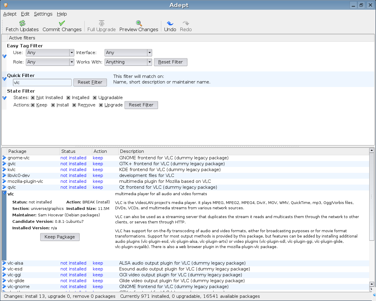

x-ray-cat Skrevet 14. oktober 2005 Forfatter Skrevet 14. oktober 2005 Kanskje denne skjermdumpen sier noe om pakkene ikke er 100%, Prøvde å installere vlc her.
