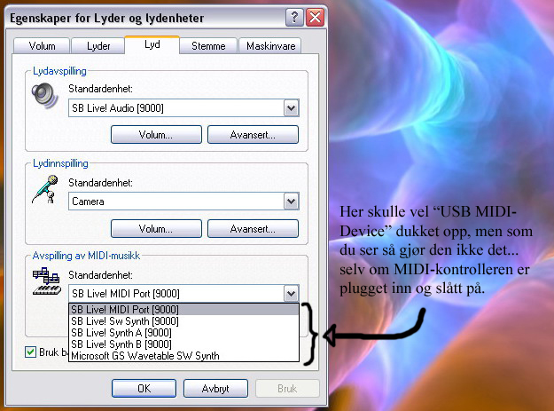

Jack Jazzrabbit Skrevet 14. mars 2005 Forfatter Skrevet 14. mars 2005 Problemet mitt grunner vel i at jeg ikke finner "USB MIDI-Device" noen steder, ikke engang i kontrollpanelet for "Lyder og Lydenheter" i WinXP (se vedlagt bilde) Skjønner ikke hva det er jeg gjør galt...
Skagen Skrevet 15. mars 2005 Skrevet 15. mars 2005 (endret) FAQ fra m-Audio.com: Q: I cannot install my USB MIDISport or Keystation (or any other M-Audio device with a MIDI port) into my computer. What can be done about this? A: Windows has a limit for the number of MIDI ports that can be installed in the operating system. Once this number has been reached, the installation of additional MIDI devices fail and these devices will not show up in the device manager. Resolution: There is a file called Midifix.exe available on the driver download page for every device that includes a MIDI port for the Windows operating system. Run this file to fix this issue. There is a readme.txt that is attached with step by step instructions. Q. My new Keystation Series* Keyboard was working fine in Windows XP but after I turned it off and on again I could no longer get it to work. A: If you have been using your keyboard with MIDI software in XP and then switched it off, it is necessary to re-start your computer BEFORE switching your keyboard on again. *This document applies to the following products: - Keystation 49e - Keystation 61es - Keystation 88es - Keystation Pro88 - O2 Q: All M-Audio USB devices are currently compliant to the USB 1.1 standard. Can I use them on a USB 2.0 port? A: Yes. If you are running Windows XP, Service Pack 1 needs to be installed in order for the USB 2.0 ports to be downward compatible with USB 1.1 devices. For Windows 2000, Service Pack 4 is required. Some Mainboards/Chipsets/USB controllers require the installation of the latest drivers for these components to add full USB 1.1 compatibility. These drivers are usually available from the mainboard manufacturer's web site. Q: Can M-Audio MIDI and Audio interfaces be used with Main Boards using VIA Chipsets? A: Yes, please be aware of the following System Requirements and Tips: - Recommended are VIA Chipsets starting from the KT266A Chipset (266A, 333, 400, 400A or higher). - It is mandatory to install the most recent VIA 4-in-1 driver (4.45 or higher). This driver is usually included on the software CD of your Main Board and should be installed immediately after installing Windows and before installing the Video/Graphics card drivers. The most recent VIA-Drivers can be downloaded in the section "Technical Support > Drivers" of the following page: http://www.via.com.tw Here are some important Tips for older VIA Chipsets: - If you are using the VIA chipsets MVP3 or MVP4 and are using USB devices, you additionally have to install the USB-Filter driver. - If you have problems with USB devices running Win98SE, you should also install the following UHCD Update from Microsoft: http://support.microsoft.com/support/kb/ar...s/Q240/0/75.asp . - On older Mainboards with KT133 or KT133A Chipsets, the use of 100MHz RAM sticks or so called "Noname RAM" is not recommended. Make sure to use brand name 133MHz RAM. - Check if a BIOS Update is available for your Mainboard (Often necessary because of the Main Boards Southbridge when using older VIA Chipsets) Edit: Jeg har aldri opplevet å måtte restarte PC'en for å få brukt Keystaion 49e, så jeg vet ikke helt hvorfor de omtaler dette i FAQ'en. Kan være noe problematisk forbeholdt visse chipset/hovedkort o.l. Endret 15. mars 2005 av skag1
