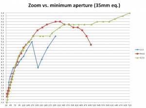

The TZ70 has a much more 'normal' Zoom versus Aperture than the F900EXR and the CX3&CX5
For all images in here, click to enlarge
But as can be seen, this means that the TZ70 has an Aperture that is inferior to the F900 by 3 to 12% at 450 to 500mm equivalent, Otherwise better or on par within 2%

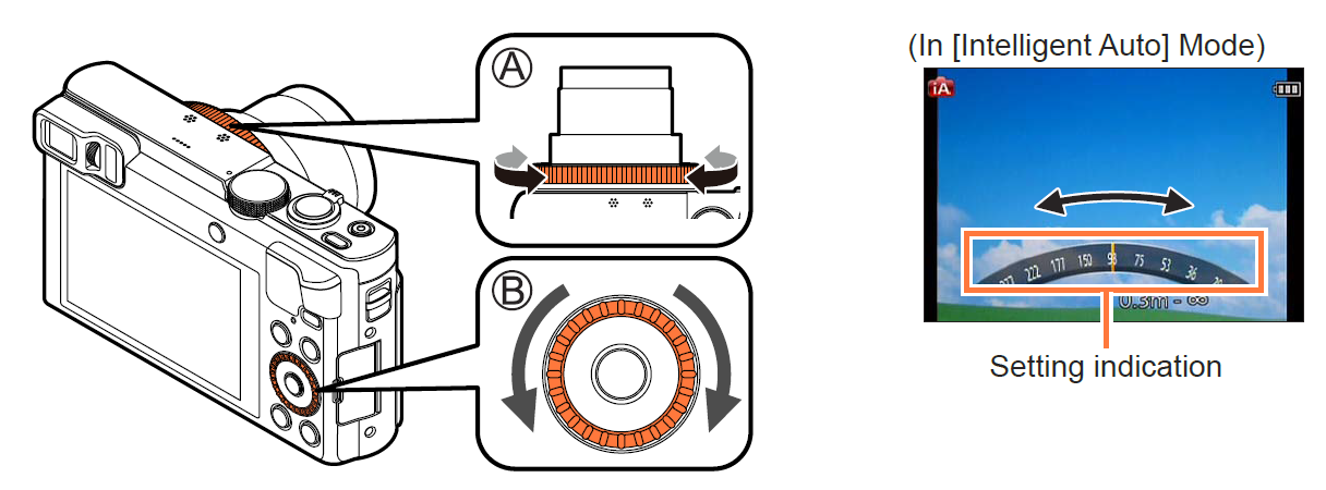

The TZ70 offers a very neat way of displaying the selected settings, that will be familiar to traditional photographers. Here from the manual:
And also a nice pair of rings to select among 'allowed' values within the automation:
I can only recommend to set the large control ring to ZOOM, and NOT the MF as you might initially think.
There are two reasons for this
1) You get a much better control of the zoom-level, than with the standard +/- control.
2) The MF with the large control ring requires a really large number of turns, making it very impractical in usage. The small control ring works fine with this, as you can easily make multiple turns whit a finger.

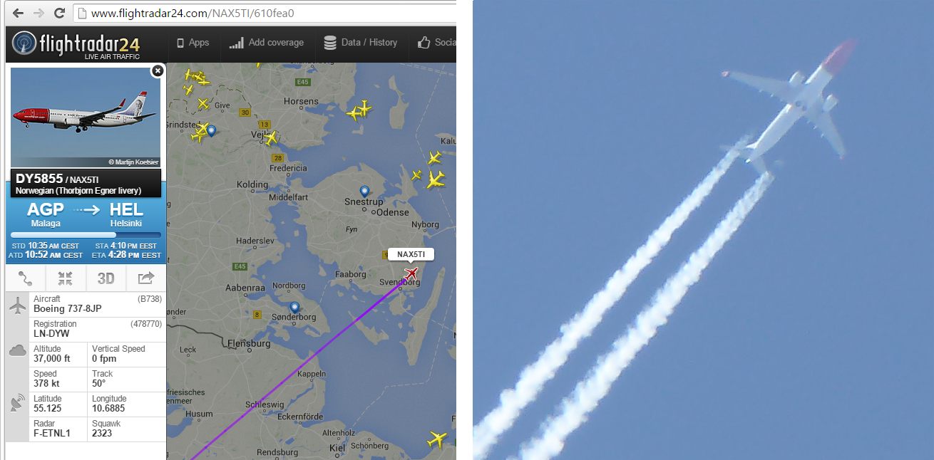

A sunny day, with an aeroplane a little over 11Km away, almost straight up. Plus Info taken from flightradar24.com in collage with a crop:
[EXIF:  800mm.eq, F6.4, 1/250s, Iso80]
post-132057-0-27918300-1430047513_thumb.jpg post-132057-0-45320600-1430664743_thumb.png
Approximately 6 pixels per metre motive.

4) The control ring is inactive in Playback - if zoom is selected in record-mode it feels natural to use it for zoom in playback
An utterly strange decision, that simply does not make sense in any way, stated in the user guide:
"When the power is supplied from an electrical outlet using the supplied AC adaptor, [Time Lapse Shot] is disabled"
This is EXACTLY the scenario when you would like to supply the camera when it is on ?!?!?!?
This ought to be fixed in a firmware upgrade....
