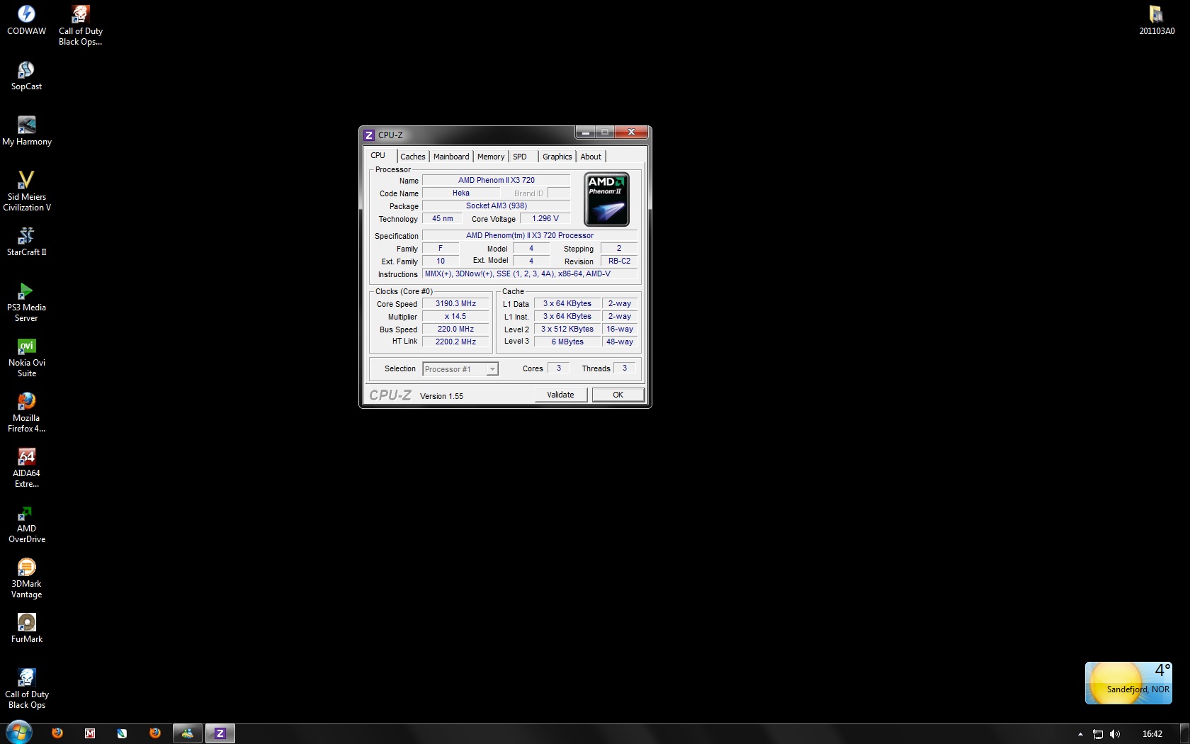

Sir_Hannibal Skrevet 15. mars 2011 Forfatter Skrevet 15. mars 2011 (endret) The best I could do is have the multiplier at 14.5 and Vcore at 1.350 Anything higher made my computer crash with blue screen's. The speed of my CPU is now 3.1 ( se vedlegg) and i dont know yet how stable it is. So far ( 15 min after clocking) it hasnt crashed yet. The temperature of my cpu ( according to AMD Overdrive and PC Probe 2,which is a software that came with the instalation CD of my CPU) is 40 degrees C. That without running anything else than Firefox,the 2 software and MSN. I don't know what the temp will be once Im starting Black Ops. I believe I just dont have the PSU to clock it at this point. I was reading on the net yesterday about overclocking my GPU and they insisted that my GPU ( an Nvidia GeForce GTS 250 aka Dark Knight) requires at least a 500w PSU. My one is 400. So I'm thinking that maybe that is the reasons why it wont let me over clock it to a higher value? /err The AMD Overdrive application actually indicates a temperature of 29-31 for my CPU. I dont know which application is lying to me. At the time of my posting,I only checked PC Probe 2,assuming that both aplication will show the same temperature. I was wrong. Endret 15. mars 2011 av Sir_Hannibal
Switters Skrevet 15. mars 2011 Skrevet 15. mars 2011 Bus speed er fortsatt satt til 220, noe som påvirker alt fra HT link, Northbridge, og RAM, så du må sette dette ned til 200 før du prøver videre. Temperatur idle betyr ingenting, du må stresse CPU med prime95 e.l. mens du leser av med f.eks. HWmonitor(fra cpuid.com)

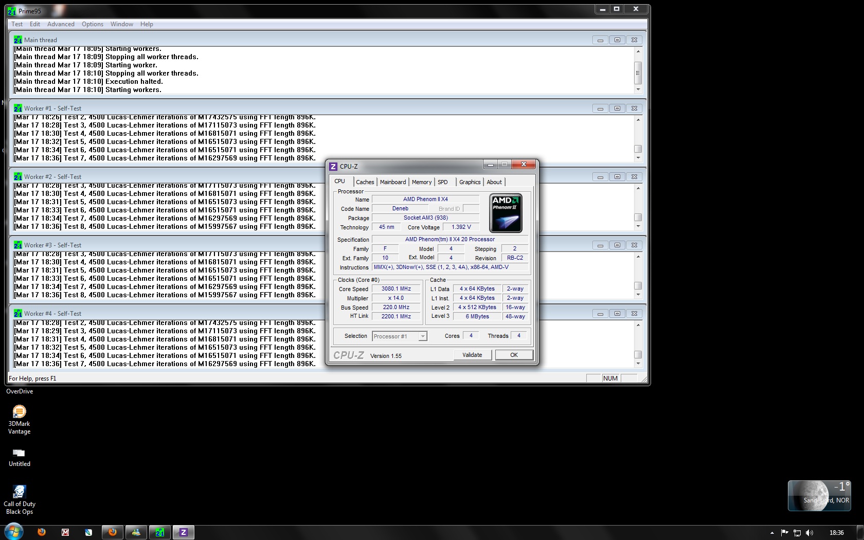

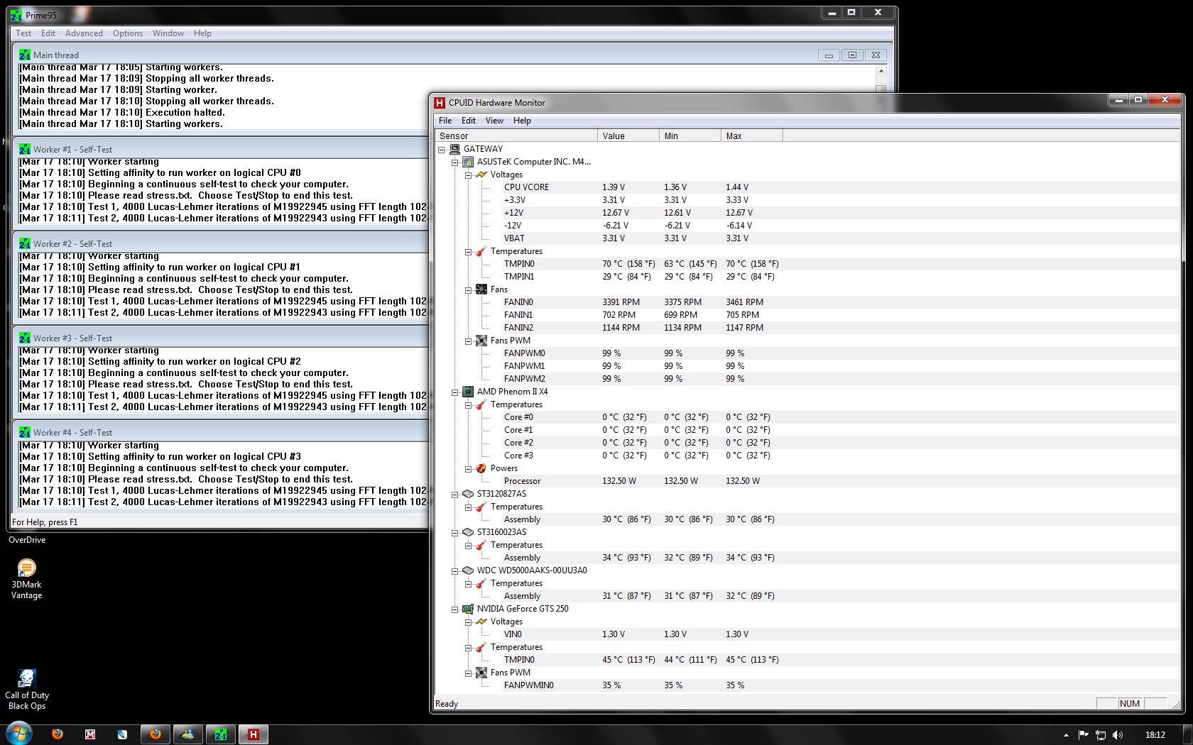

Sir_Hannibal Skrevet 17. mars 2011 Forfatter Skrevet 17. mars 2011 Well well well I lowered the buss to 200 and tried some overclocking ( not much) but it failed. At multiplier 16 and a voltage at 1.3500 ( everything above that value and the value indicator in bios turns yellow,which I consider a warning) CPUZ showed a 3.3 speed. Everything seemed normal until I start running prime95. Then it crashed. After that,I gave up and set all values back as they were and chose "unleash mode" ( from the BIOS options) instead. Is now running in 3 cores,unleashed,providing 3080 speed. However. I restarted prime 95 ( running torture mode,mainly testing temperature,voltage and a bit of ram) and 30 min into the test,I started Harware Monitor. And surprise surprise,that tool is indicating that each of my cores have a temperature of 0 degrees C have a look at the picture yourself. I'm beginning to think that I must be the most unlucky guy in the whole world ffs... Nothing works for me
Switters Skrevet 17. mars 2011 Skrevet 17. mars 2011 Hvis du åpner den siste kjerne og kjører med alle 4, vil du ikke få lest av temperatur, det er helt normalt:) Du kjører i Prime med 4 kjerner, 0,1,2,3 og hvis den er stabil en times tid med torture-test ås kan du bare bruke den sånn. Men du skriver 3080mhz. Betyr dette at unleashed-mode øker bus-speed også? Hvis du har gått fra 3 kjerne på 2,8 til 4 kjerner på 3,08 synes jeg ikke at du har vært så uheldig
Sir_Hannibal Skrevet 17. mars 2011 Forfatter Skrevet 17. mars 2011 Hvis du åpner den siste kjerne og kjører med alle 4, vil du ikke få lest av temperatur, det er helt normalt:) Du kjører i Prime med 4 kjerner, 0,1,2,3 og hvis den er stabil en times tid med torture-test ås kan du bare bruke den sånn. Men du skriver 3080mhz. Betyr dette at unleashed-mode øker bus-speed også? Hvis du har gått fra 3 kjerne på 2,8 til 4 kjerner på 3,08 synes jeg ikke at du har vært så uheldig I have no ideea if it does mate. In fact,I didnt even activated the 4th core. All I did was setting everything back to noraml ( including buss speed) and then went and chose "unleash mode" Apparently that mode unlocks the 4th core as well. I dont know. All I know is that I did that,then I went into CPU-Z and this is what it showed me.
Switters Skrevet 17. mars 2011 Skrevet 17. mars 2011 Hvis dette er stabilt ville jeg sagt meg fornøyd tror jeg og heller lagt pengene i skjermkort, eventuelt PSU også. Tror du har fått en grei økning i ytelse. Det er ACC-mode som låser opp disabla kjerner
