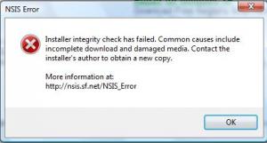

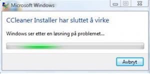

Får ikke lastet ned noe, med noen nettlesere(Update)
Uansett om jeg bruker IE eller firefox så får jeg ikke lastet ned noe som helt fra noen sider. Får bare feilmeldinger om integrity check og noe i firefox og beskjed om at filen er korrupt i IE, om de i det hele tatt blir ferdig lastet ned.
Dette gjelder samme hvilken fil jeg prøver å laste ned, uanset kilde.
Legger ved bilde av noen av feilmeldingene.
Endret av olavgulb
Kan vel også legge til hva jeg har prøvd for å få det til å funke:
1. Clear your browser's cache.
2. Disable any download accelerators or managers and download the installer again.
3. Rename the installer so it is a simple one-word name with no special characters (without removing the .exe suffix)
Example: install.exe
4. Download the installer from another source approved by the software developer or publisher.
It might be corrupted on the server, or the connection to the server is unreliable from your location.
5. Update your anti-virus software (if installed) and download the installer again.
6. Disable your anti-virus software and download the installer again.
7. Download the installer using another computer and copy it to the original computer.
8. If you have the nVidia firewall installed, uninstall the program and download the installer again.
9. Scan for, and remove malware and viruses on your system.
10. Scan the hard drive using scandisk, chkdsk, or any other hard drive repair tool.
11. As a last resort, the installer can be executed even though it's corrupted. To bypass the corruption test, pass /NCRC on the command line. To do so, go to Start->Run, type cmd and hit Enter. A black console window should open. Drag the installer into the window, hit Space and type /NCRC. Hit Enter again and the installer should start. This is not recommended!
Har gjort det som er å gjøres av de tingene over der.
12. Lastet ned NSIS installer manuelt for å prøve å installere den.
13. Satt ned sikkerheten i IE for at filene ikke skulle bli blokkert siden de ikke har en gyldig signatur.
14. Prøvd å lage en ny bruker med administratorrettigheter og logget på den i tilfelle det var noen instillinger på den andre brukeren som gjorde det.
15. Prøvd både kjør, lagre, og kjør som administrator.
16. Skrudd av brannmuren og prøvd.
Dette er på en ny ferdigkjøpt datamaskin med 64 bits Vista. Det har aldri funket å laste ned noe enda.
Mvh Olav B, G ;)
Endret av olavgulb
Vet ikke om dette kan være problemet ditt, siden du aldri har fått lastet ned noe?
Altså, sjekk nettverkskortet/routeren etc....
<qoute fra linken>
If you are confident and verify that the installer is indeed valid and in good condition, but still encounter the NSIS Error dialog box and stop halt and fail the installation, then another possible reason for NSIS error to appear is problematic network connectivity, either due to faulty network card, or Internet or LAN connection to upload, download and transfer files been blocked or restricted.
Network adapter failure is unlikely to be a common cause, unless you have problem surfing or downloading the file too. So, the resolution to NSIS Error can come down to simply checking if there is any firewall or other security software running on the computer that causing the NSIS Error.
One possible candidate is Windows Firewall which exists in Windows XP and later operating system such as Windows 2003, 2008 and Windows Vista. The solution is to disable the Windows Firewall and run the installer again.
Other reported problem maker that trigger NSIS Error include integrated nVidia NIC (network interface card) that includes a firewall. In this case, user have to change the network adapter to one without firewall or switch to wireless network temporarily to get the installer installed, as disabling the network card will still cause NSIS Error.
</qoute fra linken>
Endret av oldis
Glemte å skrive at jeg har testet med å skru av brannmuren også ja.
Og usikker på hvilke innstillinger jeg skal se etter i nettverket/routeren..?
Mvh Olav B, G ;)
[bump] Det funker å laste ned torrents og åpne de i en torrentklient, men er litt tungvindt synes jeg, i tillegg til at man da ikke alltid finner det man vil, eller at det følger med noe ekstra man ikke vil ha.
Mvh Olav B, G ;) [/bump]
