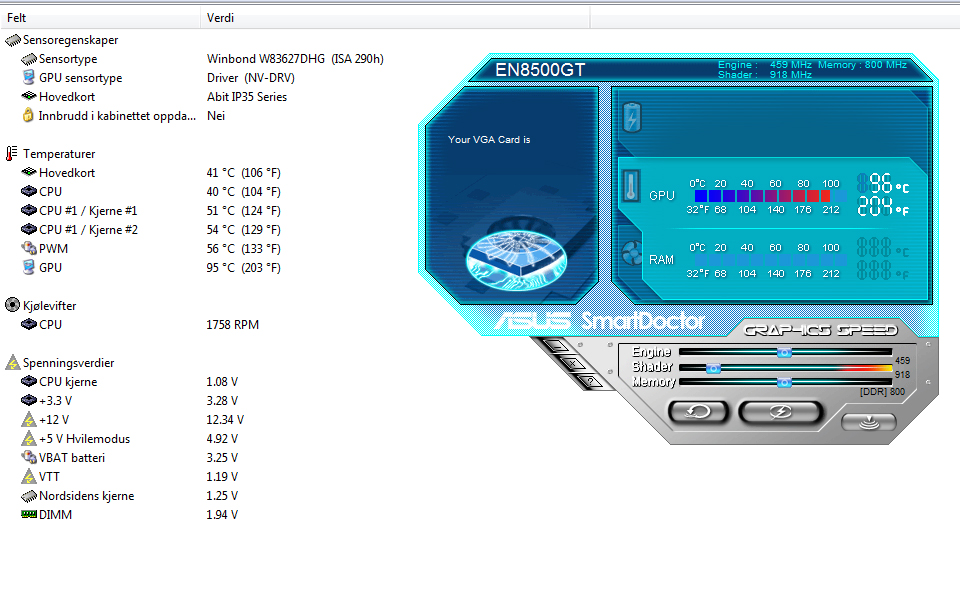

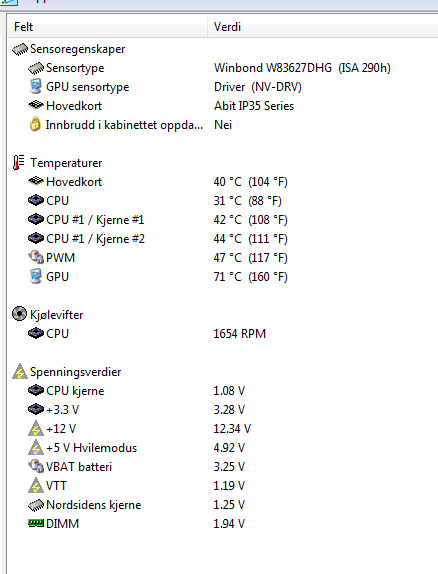

gisleiver Skrevet 27. mai 2008 Skrevet 27. mai 2008 Hei hå. Har et Nvidia 8500gt, kunn kjøleribbekjølt. Under vanlig vistabruk ligger gpu temp på 75-80grader c. Er ingen "storspiller" men prøvde et helt enkelt bilspill, da steg gpu temp til 90-100 grader... Er dette normalt, event hvor mye tåler gpu. Har ingen stabilitetsproblemer. Temp er målt både i everest og smart doctor som fulgte med kortet.

gisleiver Skrevet 27. mai 2008 Forfatter Skrevet 27. mai 2008 Er det overklokket? (nei)Mye støv på? (nytt for 4mnd siden, minimalt) Er det god sirkulasjon i kabinettet ditt? (dårlig) Vurdert å sette på vifte? (helst ikke, tilnærmet lydløs ellers)

gisleiver Skrevet 27. mai 2008 Forfatter Skrevet 27. mai 2008 Fra newegg customer reviews:"Pros: Nada Cons: Absolutely does not work correctly. Burns way too hot even with extra fans and the driver install is faulty." Skal sjekke nærmere. Ser ut til at det er flere som har prob: Hi to everyone .. Just a simple question.. I recently purchased an Nvidia Asus EN8500GT Silent. I purchased it mainly for the fact that is passively cooled and then "silent"(i use the pc mainly for composing music ..) The only game i play is World of Warcraft. I am worried about 2 things.. 1)I've noticed that the card when it's idle, the temperature "float" aorund 74-77 °C when i play "wow" the temperature rise and float around 95-100° or more.. The card is NOT overclocked .. and these are the "default specs" GPU: 459 MHz, Shader: 918 MHz, Memoria: 400 MHz The question is : 1) are these temperatures normal for a silent GPU? 2)there are any risk that the "excessive heat produced by the GPU can damage "my preciuos" X-FI Extreme Music Card located below the heatsink of the GPU???!?!? (i'm worried mainly about the x-fi.... card :-) ) I've placed an exhaust fan for throwing out some hot air but the gpu temp has remained the same... Someone knows the max "non melting" temperature that a geforce 8500gt can reach? (without burning any card near it!!!! ;-) ) http://forums.nvidia.com/lofiversion/index.php?t60996.html
