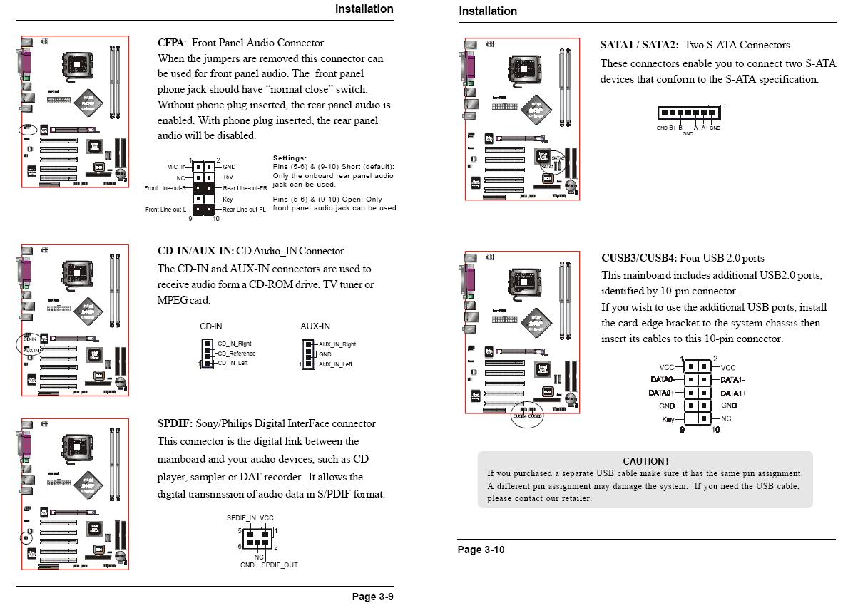

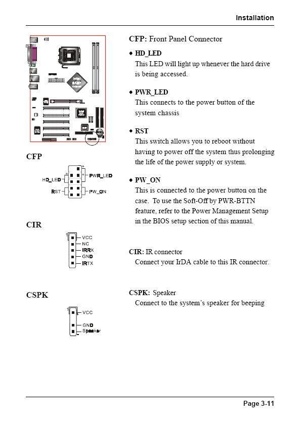

redkite Skrevet 11. september 2007 Skrevet 11. september 2007 (endret) Hi there Just received my order from pcutstyr and unfortunatly the instructions for the case was missing. Therefore Im hoping someone out there has this case and could scan the instructions and send them too me? Thanks in advance. John https://www.pcutstyr.no/main.php3?PI=info&PNO=155314 9470937[/snapback] What do you need the instructions for? I have the same case but no instructions 9471081[/snapback] Hmmm, basically because I dont know that much about computers and there are like 17 single connectors for power, usb speaker mic etc for the front panel.... And of course the names on them dont match up with the names on the motherboard... 9471178[/snapback] About the USB connectors you have to look in the motherboard manual, the same with the power, reset, hdd-led and power-led and audio. the fornt audio connectors are listed on pcutstyr.no X-Gear - Motherboard MicBias - Micpwr ReturnL - Bline_out_L ReturnR - Bline_out_R Ground - agnd Spkout L - Line out_L Spkout R - Line out_R Mic - Mic2 Endret 11. september 2007 av redkite

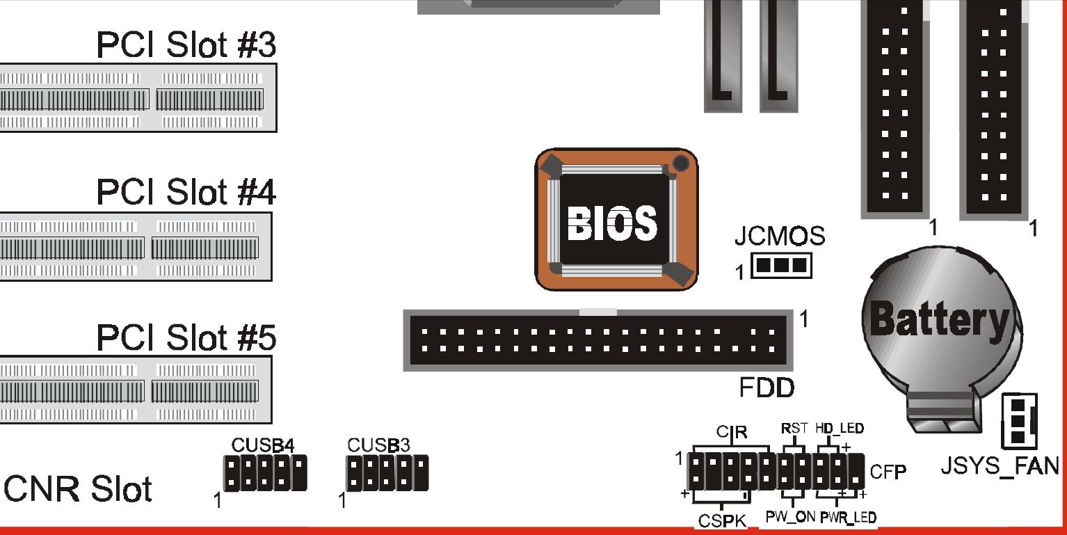

Impreza_wrcsti Skrevet 12. september 2007 Forfatter Skrevet 12. september 2007 (endret) Ok cant get it to work. Built 3 computers yesterday. 2 working fine but the last one isnt. Basically I turn it on and the graphics card isnt working. (Black screen) All fans working and I know graphics card is fine as it was checked in another machine. Also when the ide cable isnt in the dvd burner it works yet when I plug the ide cable back into the dvd burner it stops working. I thought it was a power supply issue but changed it for another one and the same symptoms. Therefore Im thinking I have made a mistake with the wiring from the cabinet to the motherboard. So hoping someone can confirm where the wires should go in case I have placed one incorrectly. The 4 bunches of wires in the casing are as follows. 1: POWER SW RESET SW 2: (1) +VCC (1) -D (1) +D (1) Ground 3: (2) +VCC (2) -D (2) +D (2) Ground 4: Mic Bias Spkout L Spkout R Return L Return R Ground Mic in If you can help I would be very grateful. Thanks alot John Endret 12. september 2007 av Impreza_wrcsti
