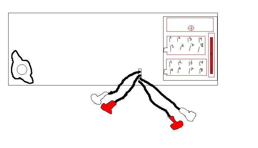

Så jeg lurer hvordan skal jeg koble
Slik ser det ut bak spilleren :)
Også står det på en klistre lapp :
B. Lound speaker
1.Violet-Right rEar (+)
2.violet/black-Right rEar (-)
3.Gray- Right front (+)
4Gray/black-Right front(-)
5White-Left- front(+)
6White/black -Left front(-)
7Green- Left rear(+)
8Green/black- Left rear (-)
A. Electronic connections
1Brown -T.mute
4Yellow - +12V (back up)
5Blue - +12V (electric antenna)
6Pink - Dimmer
7Red - +12V supply (from ignition lock)
8Black - Earth
Noe sier meg at jeg mangler noen kabler?
