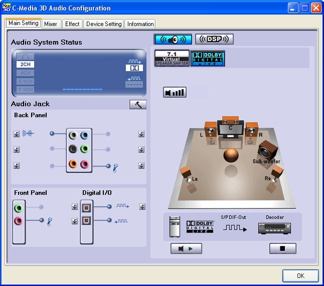

I have ASUS P5AD2-E Premium motherboard with integrated C-Media audio chip CMI 9980. I would like to use optical audio out socket to get unprocessed digital audio signal to my AV receiver, that should process the signal and distribute to the right channels. However I do not find an option in C-Media Audio 3D Configuration window to select. The only time I get some audio out is when I select Digital Audio Live button, but I believe this option is actually process the siganl and sends out analog signal to AV Receiver via optical cable. I come to that conclusion, since I can control sound volume from PC. This is not an option if I get digital sound from other sources. In those cases I can only regulate sound on my AV receiver, since that is where sound is processed and amplified.

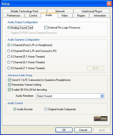

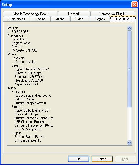

post-74178-1159692121_thumb.jpgpost-74178-1159692137_thumb.jpgpost-74178-1159692158_thumb.jpgHi added three screenshots to ilustrate what I am talking about. One screenshot is from C-Media 3D Audio configuration and two others are from WinDVD v6, where I can open files with DTS or DD sound and play back. I can get 5.1 sound if I direct sound through Audigy 2 soundcard to my 5.1 speaker setup for PC. However, when I direct sound to the onboard C-Media card (which has optical out jack), I do not get an option to pass S/PDIF out.
