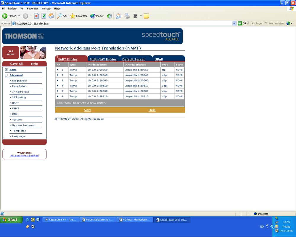

brazir Skrevet 29. april 2005 Skrevet 29. april 2005 Har på feelingen at dette er sagt før, men lell Broadband Router SpeedTouch 510/530 (Thompson/Alcatel) 1. Find out your computers internal network IP. Under Windows Go to START button -> run , type in CMD in the box and hit enter. A black DOS box will open, at the prompt type in IPCONFIG and hit enter. Note down the result you are given under "IP Address", typically something like 192.168.xxx.xxx (where the x's could be any number), make sure to put down the numbers including the dots inbetween. If the IP doesn't begin with 192.168, then please let me know. After you took down the IP Address you may close the black DOS box. 2. Open a new Internet Explorer window. In the address bar type the ip address of your router. This ip address is http://10.0.0.138 by default. Press enter. 3. You should now see the Setup Wizard. Click the Plus sign next to Advanced on the left hand side of your screen. 4. You should now see another list under advanced. Go ahead and click the NAT link. 5. Click New at the bottom of the screen to add a new entry. Select the protocol TCP of the ports you wish to forward using the Protocol drop down box. Enter the port you wish to forward in both the Inside Port (9793 and 9795) and Outside Port (9793 and 9795) box. Enter the ip address (from Step 1) you wish to forward these ports to into the Inside IP box. The Outside IP address box should be set to 0.0.0.0 unless you have multiple external ip addresses. Most people do not have external ip addresses. External ip addresses can usually be ordered from your isp at an extra cost. If you have multiple external ip addresses you can enter one of them in the Outside IP address box. Click Apply at the bottom of your screen. You should now see the configuration you just created in the table. 6. Click Save All in the menu on the left hand side of your screen Portene du ønsker å åpne er vel muligens forskjellig da men.
sec Skrevet 29. april 2005 Forfatter Skrevet 29. april 2005 Tror kanskje vi er på rett vei her.. men den her: 192.168.xxx.xxx, det fikk jeg ikke opp når jeg åpnet ipconfig!? Ingenting som lignet engang faktisk...
mr_trout Skrevet 29. april 2005 Skrevet 29. april 2005 (endret) xxx står for en hvilken som helst verdi mellom 0 og 255. Dersom du ikke så noen verdi som lignet, sto det kanskje noe som lignet på 10.0.0.xxx Edit: trykkleif Endret 29. april 2005 av mr_trout
sec Skrevet 29. april 2005 Forfatter Skrevet 29. april 2005 Ok, da stemmer det. Men, vi er fortsatt tilbake der vi startet for vi har jo gjort det "riktig" frem til nå da...
brazir Skrevet 29. april 2005 Skrevet 29. april 2005 trodde det stod unspecified jeg men....det er vel 0.0.0.0 det da
sec Skrevet 29. april 2005 Forfatter Skrevet 29. april 2005 Hvis noen har flere tips her så ville det vært helt topp... Må da finnes noen som vet hvor problemet ligger?
madammim Skrevet 29. april 2005 Skrevet 29. april 2005 Har et forslag her. Det forutsetter at du har en brannmur i router eller en software mur... Gå til CMD. Skriv: telnet xxx.x.x.xx (ip til modem) Skriv inn brukernavn og passord. Skriv følgende: ip config firewalling=off Skriv følgende: saveall Så kan du skrive exit, før du restarter modemet. Du har nå slått av brannmuren i modemet, og bør ha en annen brannmur å støtte deg til...
zits Skrevet 30. april 2005 Skrevet 30. april 2005 (endret) Har du en router mellom modem og pc?? Da kan det hende du må inn på routern og åpne der og. Hvis du har det så prøv å gå inn på router'n og åpne portene der Endret 30. april 2005 av zits
sec Skrevet 30. april 2005 Forfatter Skrevet 30. april 2005 madammim: Dette med brannmur har vi testet tidligere; uten hell! Zits: Har kun modem med innebygget router! Så det er på modemet vi må åpne portene...
Knast Skrevet 30. april 2005 Skrevet 30. april 2005 oisann.. blandet modem og router foran her... kommer mer på plass da.. men, hva er da standard IP til SMC Barricade 802.11g Wireless m/innebygd printserver?
sec Skrevet 30. april 2005 Forfatter Skrevet 30. april 2005 Føler kanskje at det ikke finnes noe mer å prøve for å få åpnet disse portene.... Ska gi det litt tid for å se om det løser seg, hvis ikke smeller jeg modemet i bridgemodus! Har folk her fått det til i praksis eller er tipsene hentet fra nettet.. Vil seg bare ikke!
Qwem Skrevet 30. april 2005 Skrevet 30. april 2005 Ofte det faktisk hjelper og la modemet stå uten strøm i 30-40 sekunder etter at du har konfigurert dette, samt trykket på save all. Virker som om enkelte versjoner av 510i ikke klarer og skifte modus mens det står på, men så lenge det får starte opp igjen, så er alt på plass Funka hos meg en gang i tiden. Eller, har du en ruter til i huset, sett opp 510i som vanlig modem, og styr med forwarding på andre ruteren din.
electr0nique Skrevet 30. april 2005 Skrevet 30. april 2005 Noen som vet hvordan en forwarder en port range på disse? (1024-2000)
sec Skrevet 30. april 2005 Forfatter Skrevet 30. april 2005 Ofte det faktisk hjelper og la modemet stå uten strøm i 30-40 sekunder etter at du har konfigurert dette, samt trykket på save all. Virker som om enkelte versjoner av 510i ikke klarer og skifte modus mens det står på, men så lenge det får starte opp igjen, så er alt på plass Funka hos meg en gang i tiden. Eller, har du en ruter til i huset, sett opp 510i som vanlig modem, og styr med forwarding på andre ruteren din. Funket ikke dette heller..... Nærmer meg smertegrensen nå!!
