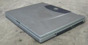

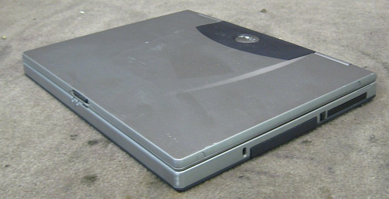

As to the computer I'm going to mod, it's one of the best computers as of the year 2000. It's the Dell Latitude L400. 700 MHz of RAW power, matched with 128 MBs of RAM, and a ATI RAGE Mobility card with the staggering 4 MBs of memory. Thats even SICK for todays standards. Not. It's got a compact and nice body though, and it's boasting a great keyboard, and a 12" 1024x768, whick will be great for my usage.
The idea is to get this computer to be a snappy computer for programming java. Since I'm using a CF card with only 4 GBs of memory, and the fact that the computer is specced like a pre-1990s LADA, DSL is the one and only OS for this computer. Being so that DSL runs directly from the RAM, the slower(?) CF-card is no obstacle for me on my way to kicking some oracle ass.

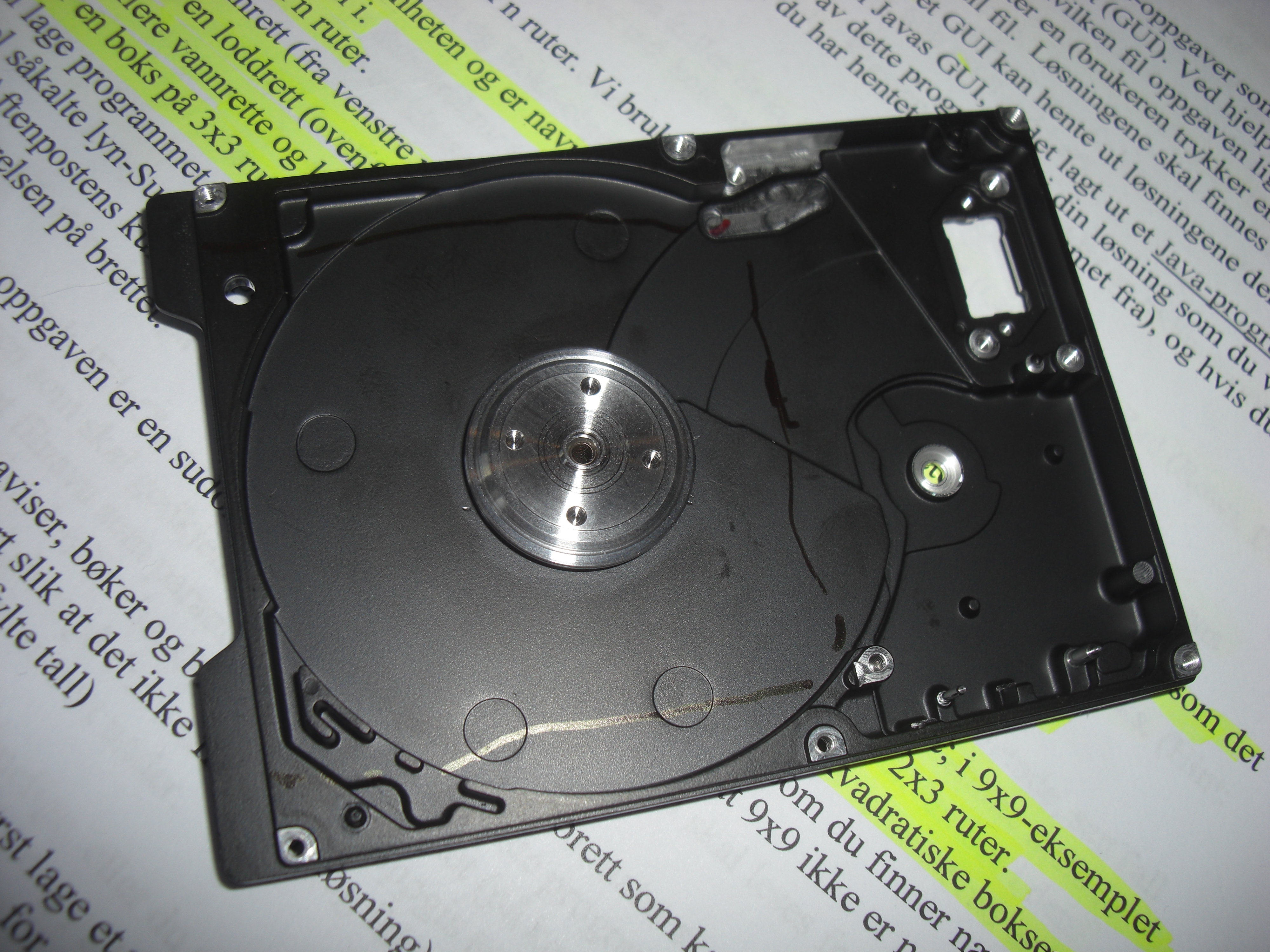

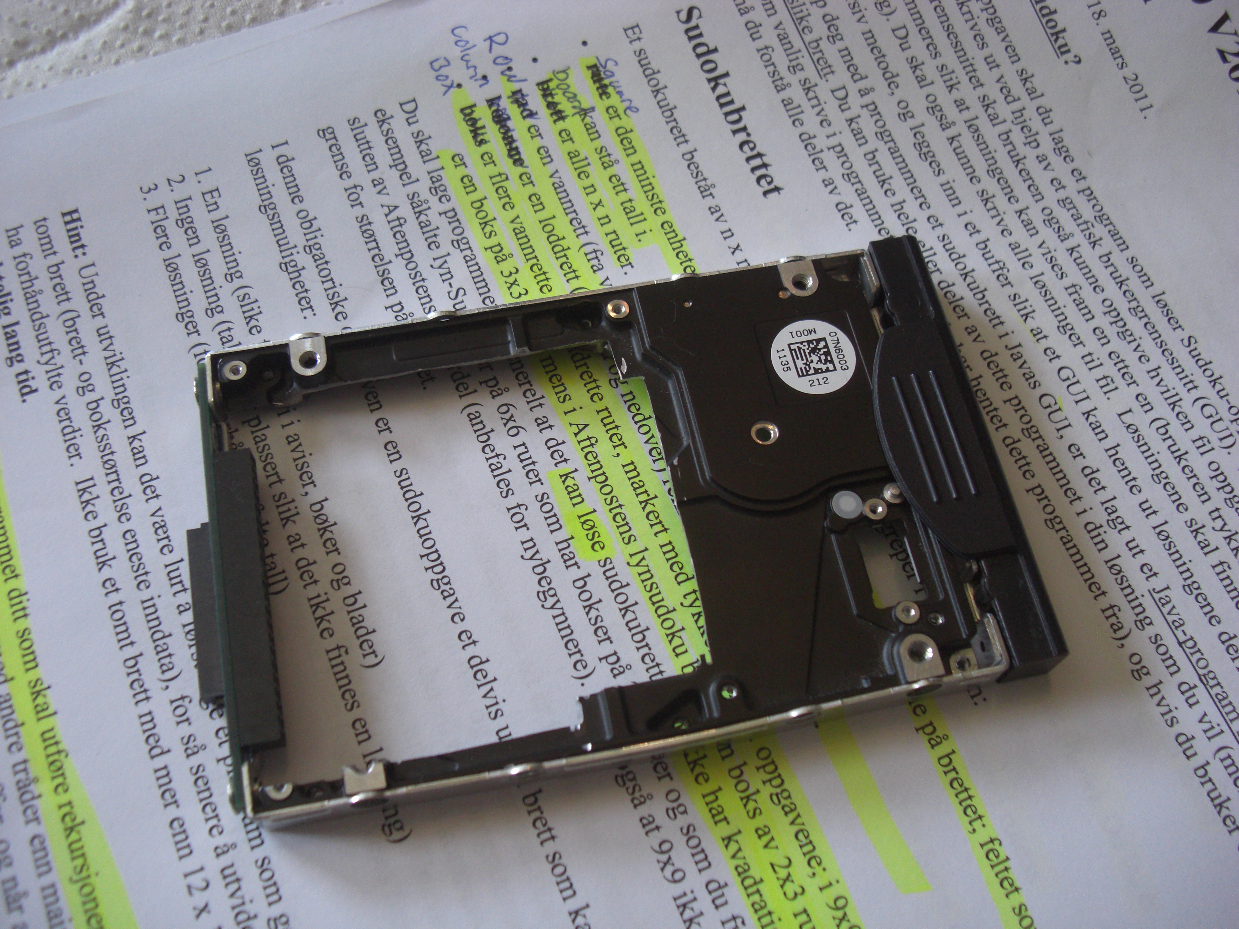

I started with a 2.5 inch IDE hdd from the computer. It was 10 GB, so I didn't really mind cutting it up.
Then I cut that shait into pieces

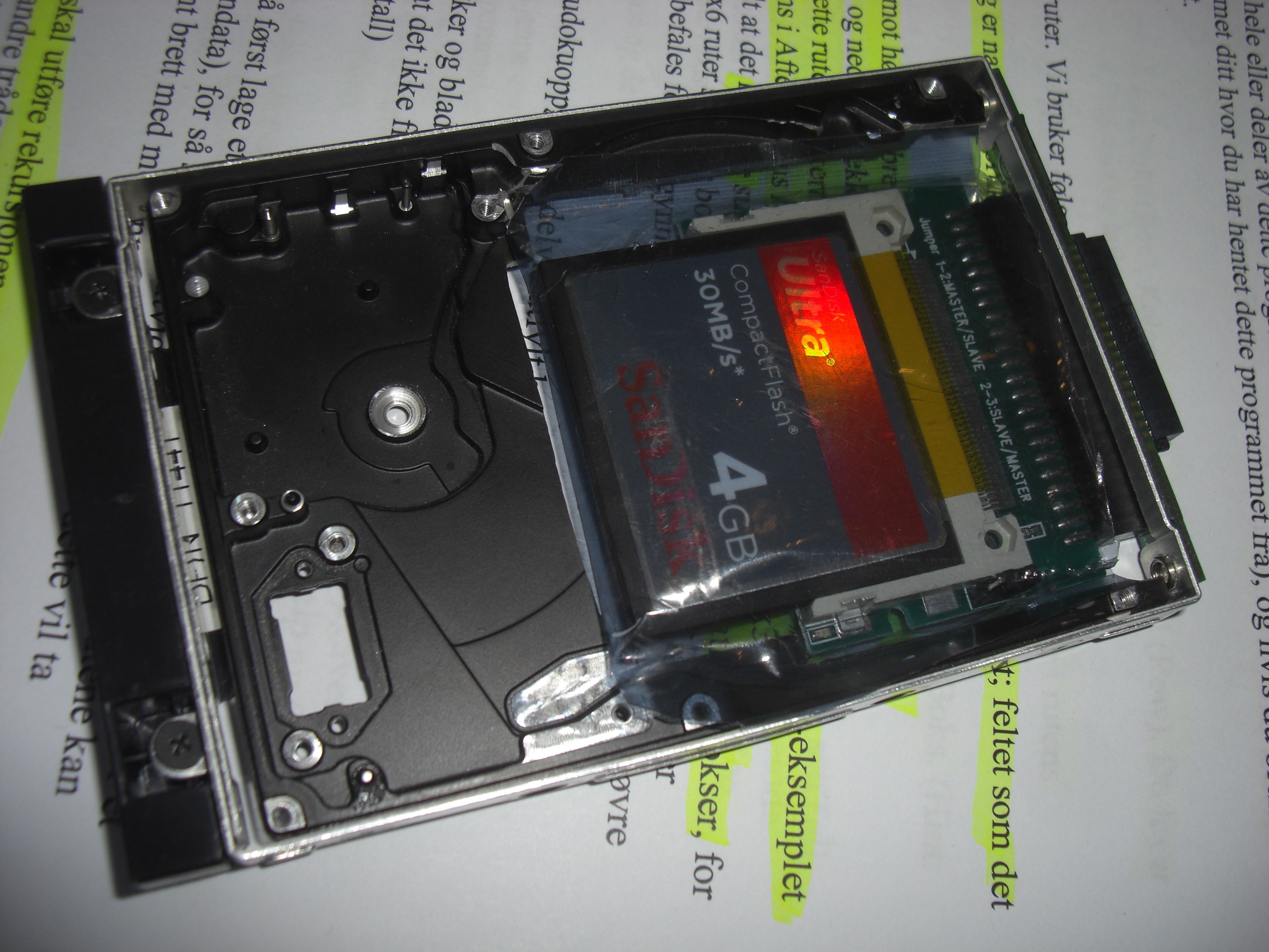

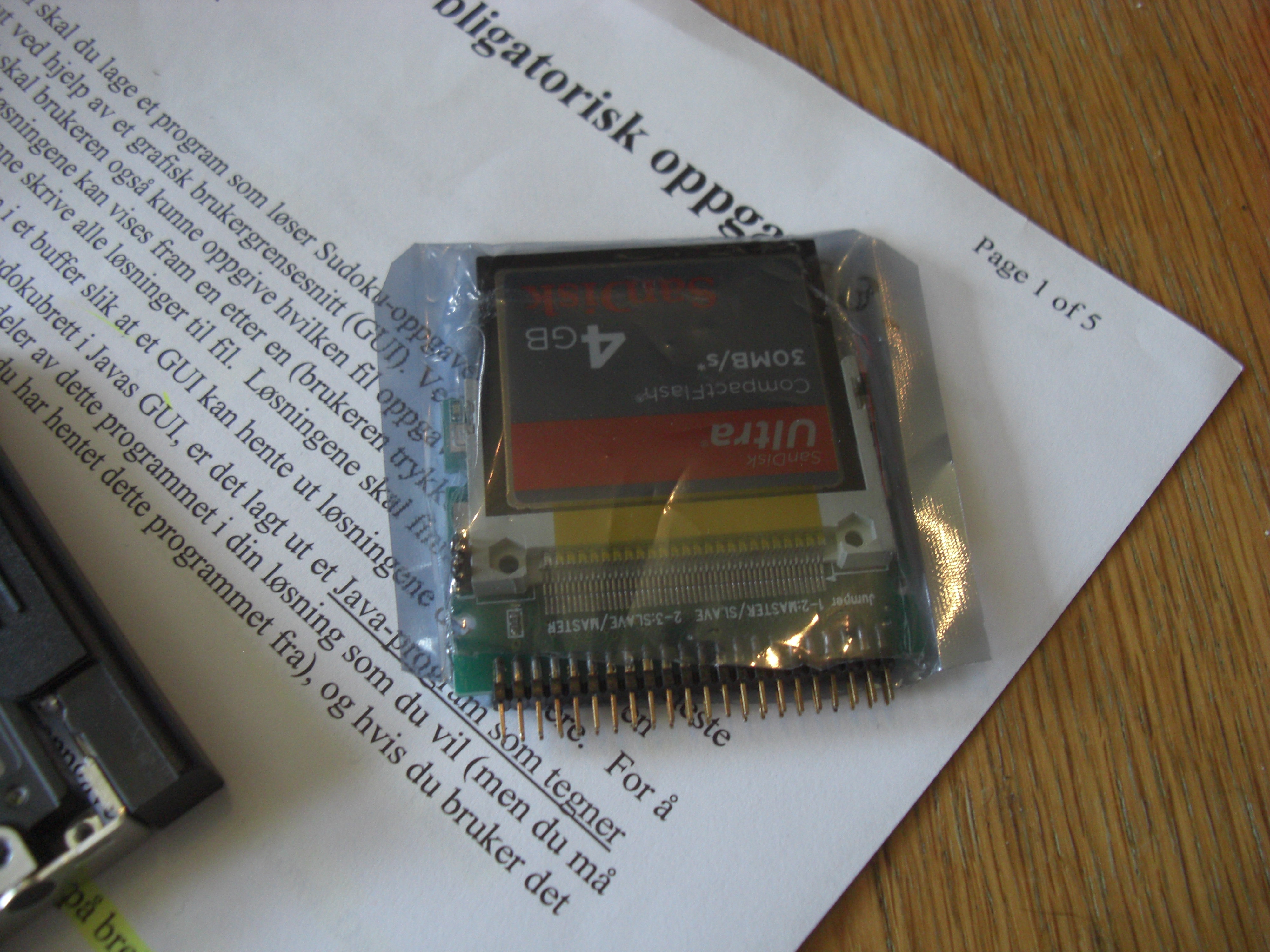

I put the CF-card and the adapter in a anti-static bag to prevent shortcuts.
Then I mounted the CF card inside the HDD-shell inside the HDD-tray. The HDD-shell is for mounting purposes only.
And voila!
