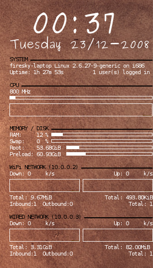

Firesky Skrevet 22. desember 2008 Rapporter Del Skrevet 22. desember 2008 Hmm.. min conky: # Create own window instead of using desktop (required in nautilus) own_window yes own_window_type override own_window_transparent yes own_window_hints undecorated,below,sticky,skip_taskbar,skip_pager # Use double buffering (reduces flicker, may not work for everyone) double_buffer yes # fiddle with window use_spacer yes use_xft yes # Update interval in seconds update_interval 2.0 # Minimum size of text area # minimum_size 250 5 # Draw shades? draw_shades no # Text stuff draw_outline no # amplifies text if yes draw_borders no uppercase no # set to yes if you want all text to be in uppercase font Bitstream Vera Sans Mono:size=8 # Stippled borders? stippled_borders 3 # border margins border_margin 9 # border width border_width 10 # Maximum width in pixels maximum_width 287 # Default colors and also border colors, grey90 == #e5e5e5 default_color white own_window_colour brown own_window_transparent yes # Text alignment, other possible values are commented #alignment top_left alignment top_right #alignment bottom_left #alignment bottom_right # Gap between borders of screen and text gap_x 1 gap_y 16 # stuff after 'TEXT' will be formatted on screen TEXT $color ${font Purisa:size=50} ${time %H:%M}${font Bitstream Vera Sans Mono:size=8} ${font Purisa:size=18}${time %A %d}/${time %m}-${time %Y}${font Bitstream Vera Sans Mono:size=8} ${color 000000}SYSTEM ${hr 2}$color $nodename $sysname $kernel on $machine Uptime: $uptime $alignr $user_number user(s) logged in ${color 000000}CPU ${hr 2}$color ${freq} MHz $cpubar ${cpugraph 000000 704214} ${color 000000}MEMORY / DISK ${hr 2}$color RAM: $memperc% ${membar 6}$color Swap: $swapperc% ${swapbar 6}$color Root: ${fs_free /} ${fs_bar 6 /}$color Preload: ${fs_free /media/Preload} ${fs_bar 6 /media/Preload}$color ${color 000000}WiFi NETWORK (${addr wlan0}) ${hr 2}$color Down: $color${downspeed wlan0} k/s ${alignr}Up: ${upspeed wlan0} k/s ${downspeedgraph wlan0 25,140 000000 704214} ${alignr}${upspeedgraph wlan0 25,140 000000 704214}$color Total: ${totaldown wlan0} ${alignr}Total: ${totalup wlan0} Inbound:${tcp_portmon 1 32767 count} Outbound:${tcp_portmon 32768 61000 count}${alignr}Total: ${tcp_portmon 1 65535 count} ${color 000000}WIRED NETWORK (${addr eth0}) ${hr 2}$color Down: $color${downspeed eth0} k/s ${alignr}Up: ${upspeed eth0} k/s ${downspeedgraph eth0 25,140 000000 704214} ${alignr}${upspeedgraph eth0 25,140 000000 704214}$color Total: ${totaldown eth0} ${alignr}Total: ${totalup eth0} Inbound:${tcp_portmon 1 32767 count} Outbound:${tcp_portmon 32768 61000 count}${alignr}Total: ${tcp_portmon 1 65535 count} Lenke til kommentar

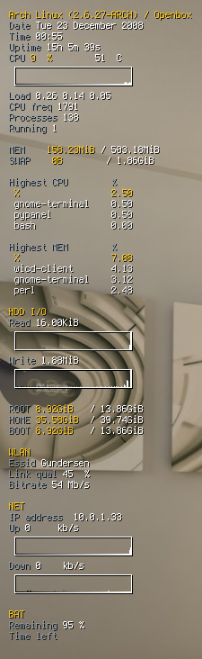

Smif Skrevet 23. desember 2008 Rapporter Del Skrevet 23. desember 2008 Min: background yes use_xft yes xftfont Terminus:size=8 xftalpha 0.8 out_to_console no update_interval 2.0 total_run_times 0 own_window no double_buffer yes minimum_size 1000 5 draw_shades yes draw_outline no draw_borders no stippled_borders 8 border_margin 4 border_width 1 default_color white default_shade_color black default_outline_color white alignment top_left gap_x 10 gap_y 10 no_buffers yes uppercase no cpu_avg_samples 2 net_avg_samples 2 override_utf8_locale no use_spacer yes TEXT ${color #ddaa00}Arch Linux ($kernel) / Openbox ${color slate grey}Date ${color }${time %a} ${color }${time %e %B %G} ${color slate grey}Time ${color }${time %H:%M} ${color slate grey}Uptime ${color }$uptime ${color slate grey}CPU${color #ddaa00} $cpu% ${color }${acpitemp}C ${cpugraph 20,130 000000 ffffff} ${color slate grey}Load ${color }$loadavg ${color slate gray}CPU freq ${color }${freq_dyn} ${color slate grey}Processes ${color }$processes ${color slate grey}Running ${color }$running_processes ${color slate grey}MEM ${color #ddaa00}$mem${color } / $memmax ${color slate grey}SWAP ${color #ddaa00}$swap${color } / $swapmax ${color slate grey}Highest CPU % ${color #ddaa00} ${top name 1} ${top cpu 1} ${color lightgrey} ${top name 2} ${top cpu 2} ${color lightgrey} ${top name 3} ${top cpu 3} ${color lightgrey} ${top name 4} ${top cpu 4} ${color slate grey}Highest MEM % ${color #ddaa00} ${top_mem name 1} ${top_mem mem 1} ${color lightgrey} ${top_mem name 2} ${top_mem mem 2} ${color lightgrey} ${top_mem name 3} ${top_mem mem 3} ${color lightgrey} ${top_mem name 4} ${top_mem mem 4} ${color #ddaa00}HDD I/O ${color slate grey}Read${color } ${diskio_read} $color0} $color${diskiograph_read 20,130 000000 ffffff} ${color slate grey}Write${color } ${diskio_write } $color0} $color${diskiograph_write 20,130 000000 ffffff} ${color slate grey}ROOT ${color #ddaa00}${fs_free /}${color } / ${fs_size /} ${color slate grey}HOME ${color #ddaa00}${fs_free /home}${color } / ${fs_size /home} ${color slate grey}BOOT ${color #ddaa00}${fs_free /boot}${color } / ${fs_size /boot} ${color #ddaa00}WLAN ${color slate gray}Essid ${color }${wireless_essid wlan0} ${color slate gray}Link qual ${color }${wireless_link_qual_perc wlan0}% ${color slate gray}Bitrate ${color }${wireless_bitrate wlan0} ${color #ddaa00}NET ${color slate grey}IP address ${color }${addr wlan0} ${color slate grey}Up ${color }${upspeed wlan0} kb/s ${upspeedgraph wlan0 20,130 000000 ffffff} ${color slate grey}Down ${color }${downspeed wlan0}kb/s${color} ${downspeedgraph wlan0 20,130 000000 ffffff} ${color #ddaa00}BAT ${color slate gray}Remaining ${color }${battery_percent C137}% ${color slate gray}Time left ${color }${battery_time C137} Lenke til kommentar
